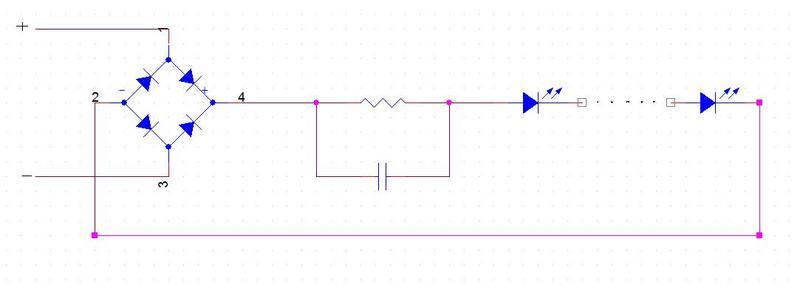

Im currently doing a LED lighting Tube. I am using 240VAC 50Hz input. The connection will be the Input Source connected through a Rectifier,then a resistor and 68pcs of LED connection. When we try to testing the circuit, all the LEDs did not light up but the 13A fuse inside the 3-pin plug burn off immediately after we turn on the switch. We connect the Life and Neutral wire to the positive and negative of our circuit.Left our the Ground wire.
So what is the problem actually that the fuse burn off immediately after we turn on the switch?Overcurrent?

You will have to do some measurements.
Measure the input resistance of the bridge rectifier (the resistance between the points where the A and N connect). If it is a short circuit, it was probably connected wrongly or maybe it did not have enough voltage rating.
You can replace it with individual diodes, but use the highest voltage rating ones you can find. 1000 volt diodes are cheap and you can easily use them.
Check every LED to see if it is the right way around and it still works.
What is the size of your resistor?
There should not be any surge currents, but it is important to find out what caused the short circuit before you apply power again.
We are trying to use small value of resistor as we want to minimized the power dissipated in the circuit.At first we use 50ohm resistor, then we try 10kohm but still the fuse get burn. We'll try to test it again and reconnect the connection of rectifier using single diode and see whether it works.

When you used a 50 ohm resistor, the peak current would have been about 2.6 amps which would have blown up some or all of your LEDs.
If you have a multimeter, you really need to go through and test everything before you apply power again.
The calculation we had make is
Source Voltage = 240V
3.5V for each LED X 68 column = 238V
Voltage consumed in each cycle for the full-wave rectifier = 1.4 V
Remaining voltage = Resistor voltage = 0.6V
Current of Resistor = 0.6V/50ohm = 12mA
I am curious how the peak current will go to 2.6A if we using 50ohm?Is our calculation wrong?

The peak value of the input voltage is 1.414 times 250 or 353 volts.
The LEDs add up to 238 volts so there is 353 minus 238 or 115 volts across your 50 ohm resistor.
So the current will be 115 volts / 50 ohms or 2.3 amps.

Did you find out why your setup was blowing fuses?
Which components were faulty?
yup because of the rectifier can't afford the voltage supply and it get burn at the 1st time we test the circuit.We replace it with 4 single diodes and now the circuit function well but weird thing is the voltage across the rectifier diode that we build is 100V++.Based on the calculation it shudnt takes so much voltage for the rectifier.

Ok..Just want to make sure again..is my calculation correct this time?
Supply voltage = 340V
Voltage consumed by 68 LEDs in series = 3.5V X 68 = 238V
Voltage consumed by diode rectifier (4 pcs of 1N4007) = 1.4V
Voltage consumed by resistor = 340 - 238 - 1.4 = 100.6V
Resistance set it to 4.5k, Hence the current is 100.6/4.5k = 22.4mA
The power of Resistance we need is at least 100.6 X 22.4m = 2.25W
Yes, that looks OK. However that is only peak current.
The average current will be about 10 mA. So the LEDs may not be very bright. They are rated at 30 mA, I think.
Try this with just the rectifiers first to make sure there are no fireworks.
The average current will be pretty low because the current only flows if the input voltage is greater than 238 volts.
http://dl.dropbox.com/u/4222062/LED%20current.PNG
If you have room, you could think about adding a capacitor across the output of the rectifier.
This would hold the 350 volts between input pulses and allow a steady current to flow in the LEDs.
The current is quite small, so about 10 uF should be enough. 450 volt rating or higher.
It would need a suitable resistor across it to discharge it when the power is turned off.
About 100 K, 2 watts.
Is the connection of capacitor and resistor in the jpeg file correct?Is that what you mean?
Hopefully the practical current will be smoothed after adding the capacitor inside the circuit.

The capacitor would be connected like this:
http://dl.dropbox.com/u/4222062/LED%20string%20with%20C.PNG
This is called a filter capacitor and it converts pulsing DC into smooth DC.
The 100 K resistor across the capacitor has to be there because otherwise the capacitor would stay charged up to about 238 volts and be dangerous even after the power was removed.
The resistor removes the charge in a few seconds.
I think I mentioned before that this is very dangerous stuff you are doing.
Do you have someone who can check your setup and advise on its safety?
That capacitor and the two resistors and the diodes should be in a sealed plastic box, at least. The 5 K resistor is going to get quite hot, so the box needs ventillation holes.
That 5 K should be 4.7 K.
The 4.7 K resistor will dissipate about 2.7 watts. (350 - 238) * 0.0238 A.
So, you could use a 5 watt resistor.
