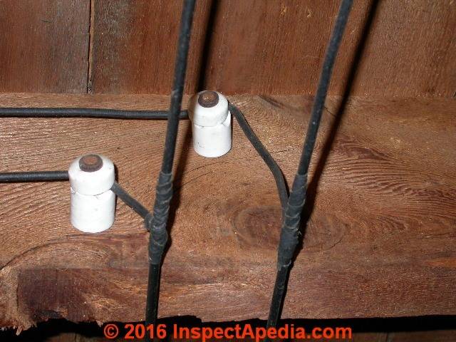

It turned out that the kitchen was powered by the original, fused box, hidden inside one of the lower kitchen cabinets. The rest of the house was powered by the breaker box.
My house was built in 1945, and my guess is the breaker box was added during the 70's.
ps. Good luck!
OmCheeto said:
... kitchen was powered by the original, fused box, hidden inside one of the lower kitchen cabinets. The rest of the house was powered by the breaker box.
You're lucky. This is what I have to deal with in my parents old house.
At least cables are kept properly distanced from the wood :wink:

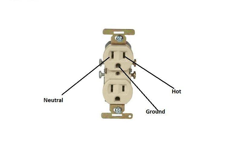

You want to see black wire into shorter of the two slots that's the hot
it's always the brass colored screws, or rear push-in holes on that side
longer slot is neutral, white wire to white screws,
