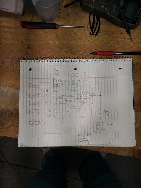

  • #76
Yes, I'll be using a 4 way switch on the start winding circuit. Since start winding power drops out after the centrifugal switch activates, changing the switch position while motor is running will not have any impact until the next start. May power it up this afternoon and If everything works like expected, I will post a detailed schematic of the setup (based largely on Jim's fantastic work).
  • #77
Good news! I was successful in starting forward and reverse and running all three speeds. Speeds were about 50 rpm higher than motor rating, but that may be the result of inaccuracies in my meter or power company running a little higher frequncy. Haven't tried depinning low speed wires from motor terminal block and just connecting together, but I'll do that this afternoon. Detailed schematic and photos will follow when I'm confident I have everything spot on.
  • #78
Update. No discernable difference in parameters or operation when bypassing motor terminal block for low speed windings so I returned to original configuration. Look for a schematic before end of week (want to take my hand drawn diagram and recreate in a graphics program at work). Some pics, including hand drawn schematic, attached. Only thing I'm missing is the 15 amp in line fuse, but I have that on order.
Pic 1 is hand drawn diagram. Look for better one later this week.

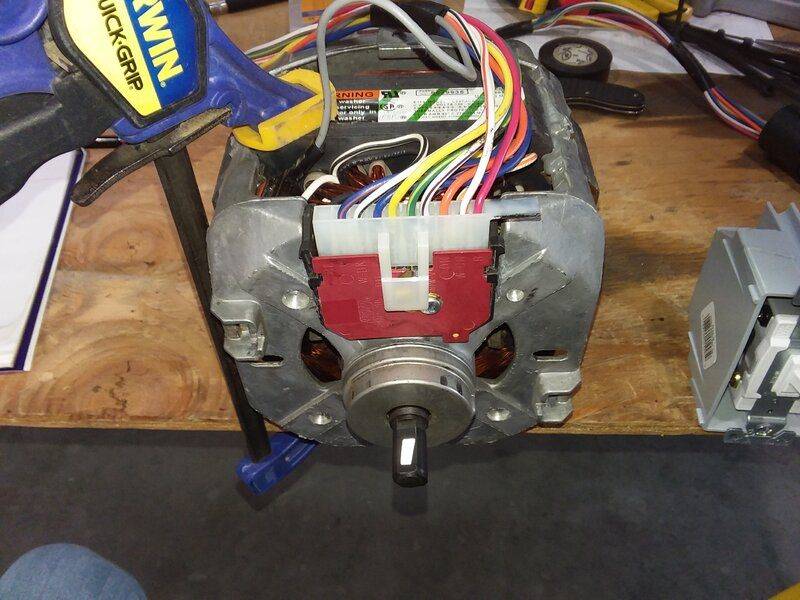

  • #79
Pic 2 is motor terminal block with all wires connected.

  • #81
As promised.
  • Love
