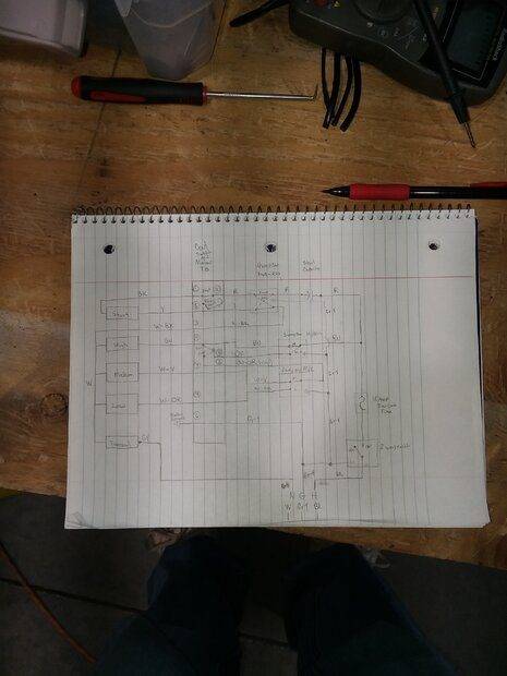

jim hardy said:
could you scan and post that diagram?
Does your motor have a centrifugal start-run switch , something like in the picture in post 7 ?
Take a picture with your cellphone, load it into paint and size to fit the PF page(about 800 pixes wide), save and use upload button..

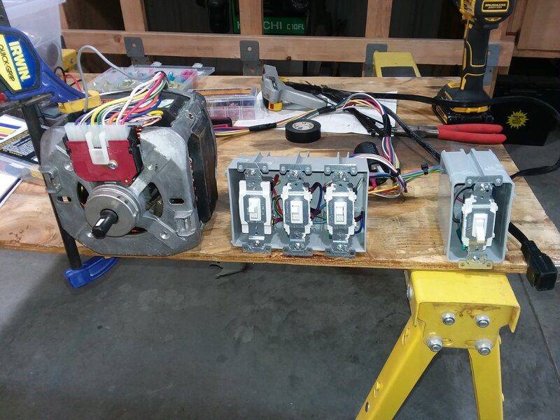

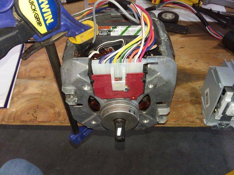

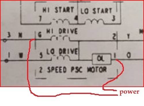

Thank you for the fast reply! I truly appreciate it.
It does not appear to have a start run switch. But these are the parts I have here with me. I will look in my garage to see if I have any of the relays. I tried to gut as much as I could in the short time I had.
I hope these pictures show up. Otherwise I will try again when I get back to my computer.

Also, here are the wires at the harness if it helps.
  • #34
Wow two start windings - never saw that before ! Not like mine.
You'll need a start-run relay.
Which speed do you want to use?
What are you making with it?

I am also making a motorized grain mill. I only need the low speed. I am hoping I have the start run relay at home in the pile of wires I pulled. I am currently at "work" but I do remember some unknown to me component taped up in the bundle. I will check that out as soon as I get home. Hopefully its the part I need!

I can't quite see the numbers in your picture of blue plug & wires, maybe you could annotate it in Paint...
Assuming they're as shown on diagram below
1. With your ohm-meter make sure NONE of the wires reads continuity to motor frame.
2. With your ohm-meter verify a few ohms, probably two or so, thru hi drive winding 6 to 2. Write down your reading.
3. With your ohm-meter verify a few ohms, probably two or so, thru lodrive winding 5 to 2. Write down your reading.
4 With your ohm-meter verify a few ohms, probably four or so, thru both windings 6 to 5. Write down your reading. Steps 1 and 2 should add to same result.
5. With your ohm-meter verify almost zero ohms, probably less than 1, thru thermal overload 2 to 1.
Now we're pretty sure we understand how motor is wired.

OK, I ran through these steps and got the results you said I would! I'm feeling pretty good now.
thru high drive winding (6 to 2) I got 3.0 Ohms
thru low drive winding (5 to 2) I got 6.3 Ohms
thru both windings (6 to 5) I got 9.1 Ohms (doesn't add up exactly, but close. I assume that's ok.)
thru thermal overload (2 to 1) I got 0.1 Ohms
I connected 6-1 and turned the switch, got the hum, turned it off. Then spun it and turned it on once in each direction. ran both ways at high speed. Then did it again at low speed, complete success!
Now to figure out how to start it. I will attach the diagram of the relay, and the actual connections on it from my phone in a few. It is late, but I hope you will have time tomorrow to review this.
Thank you so much!

And here is the relay diagram.
  • #42
Here is the wire harness numbered as best as I could

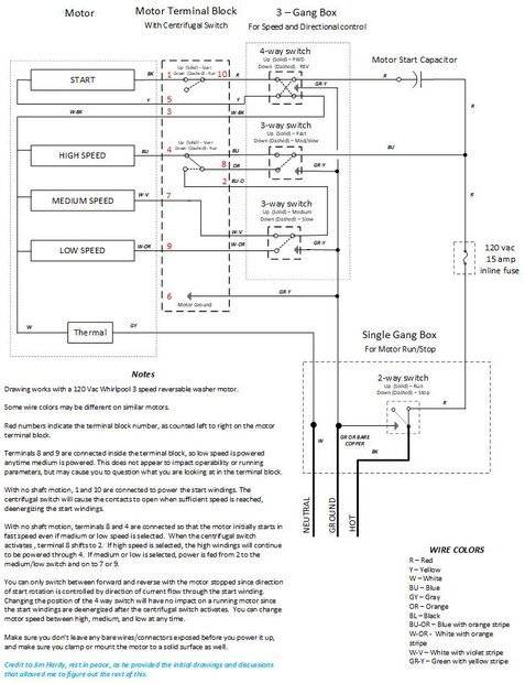

Wow i learn something with every project.
I think you lucked out with your motor. I know I'm happy for the lesson...
Every one of these i ever played with until today had a centrifugal switch to cut out the start winding.
That let's them use a cheap capacitor that's not long lived.
So, i was confused by the schematic - there's no switch to cut out the start winding !
Hmmm i guess the 'psc' by motor means "permanent split capacitor", which a type of split-phase motor where you don't switch out the "start" winding.
That's why they use a 60,000 hour rated capacitor, that's good for around five years continuous use which is not bad for a home appliance.
http://www.farnell.com/datasheets/1658206.pdf
So your task just got a lot easier.
All you have to do is wire the capacitor , which is a RUN capacitor not just a start capacitor, in series with the proper start winding..
Back to your schematic. Took me all day to figure this out...
They use the speed relay to select both the desired run winding and the accompanying start winding.
The schematic shows high speed , agitate
Trace start winding current, orange
It goes like a corkscrew - orange line
down and right through agitate relay then way up then way right then down through another agitate contact
then through speed relay bypassing "lo start" half of start winding
then down into "hi start" half of start winding
then out and up through a third agitate switch ( they used two agitate switch contacts for start winding so they can reverse motor)
then up, way way right and down then left to start(oops - make that RUN) capacitor
then on around through thermal overload and out of washer ( provided lid is closed- see lid switch interlock?)
Whew !
Red run current is a lot easier to trace.
That's high speed.
You want low speed.
So here's all you have to do to your motor.
Get power to low drive winding, and to "lo start" winding through run cap.
EDITED to correct two pin numbers-jh
1. Verify with your ohm meter there's a few ohms between 4 and 3,
a few also between 4 and 7,
and about their sum between 7 and 3.
2. Verify there's no connection between start and either of the run windings.
That tells us we've found start winding where we expected it by schematic.
Yellow wiring i think you can do with just those wires from your plug
twist 7&4 together to replace contact of relay we didnt use - though i think it'd work without doing that (i hope you try and let us know)
one side of capacitor to 2, other side to 3
5 7 and 4 to one side of power cord (i'd put black hot wire there)
1 to other side (white) of power cord
green Earth wire to motor frame
try it out. Don't ignore earthing green wire , safety first.
To make it run backwards , reverse current through start by swapping 3 and 4.
That looks good to me.
If it won't start, put your meter on highest ohms and hook across cap. It should start at zero and raise slowly. It it reads high immediately it's lost its capacitance. Try it both ways.
A new run cap won't be expensive. Good electrical supply house will have an assortment of them. Metal can style is okay, just be sure it's a MOTOR RUN not a START cap. I estimate fifteen bucks or less. My last one was seven.
Let us know
and thanks for the lesson, i'll no longer shun those type motors at the junkyard.
old jim

Jim, your instructions worked perfectly! Thank you so much.
I did forget to try not hooking it up between hi/lo start before I crimped the connections. I must have gotten too excited it worked that it slipped my mind.
In case anyone else has this same motor and is following your diagram connection "8" is actually a B (black) so the pin number should be 4. And power in "9" was an O or pin connection 1.

I am so glad I found this motor, followed by this forum! The motor was in a washing machine we had here at work that started leaking less than a year after getting it. Instead of fixing it they just bought another and left this one collecting dust. When I asked what we should do with it I was told to toss it, so I stripped it for parts! I gathered wires, mounts, and even used the washers lid as my internal panel for my electric brewing control box!
I will keep an eye on the windings to make sure its not getting too hot. I'm hoping to get this all up and running in the upcoming week! I'll post a finished picture once it is complete.
  • #47
is this right now ? ( for the next guy...)
duh, i didnt check against your most excellent photo
there is no 8 or 9 !
and i had it right on page 2 ! Dang my clumsiness !...
i went back up and fixed the numbers in the instructions post too.
old jim
  • #48
That is exactly how I have it wired, and it works perfectly (at low speed, I didn't wire it for hi speed). I might decide to set it up for both directions, I'm still undecided if it will be beneficial.
You sir are incredibly helpful and kind.

I've been using my grain mill now for a few months...probably ground 100 lbs thru it so far with no problems or over heating. I do find it better to start the mill before I load too much in the hopper. Once it's running, I can fill the hopper full. The pulleys I used do a good job of reducing the speed. Here's a link for the grinding.
  • #50
Glad to hear it's working. And i like your workmanship !

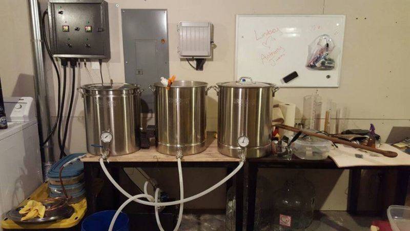

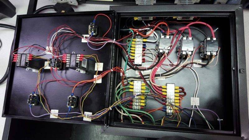

I figured I'd also show the rest of my budget basement brewey and control panel. Even doing it as cheap as possible, it still gets expensive. But if I can sell my beers for $40 each I'll be in the the black in no time! [emoji2]

BLANKAJ said:
View attachment 98675View attachment 98676
Looks like a nice system with the temp controller and all...I'm still an old school brewer that monitors my gas fired system with thermometers. My typical brew size is 13 gals using an old keg as the kettle.
