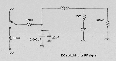

I have two coupled coils. One is being driven by a pulses. The other coil has FET switches to switch the high load path out and instead divert the induced current through a lighter load. This is necessary so that the reflected load onto the primary is minimized. The problem is that the parasitic caps (and perhaps the parasitic internal BJT) on the FETs, configured as 2 back-to-back N-channel mosfets to block any current flowing through the body diodes, cause current to flow through the FETs (remember, the voltage at the node between L2 and R2 is positive and negative). So, I cannot fully turn the FETs off, and the load on the undriven coil is not the 100k, but the 100K in parallel with the 75ohm plus the parasitic impedance presented by the FETs.
I've tried other switching elements, but I still can't get this to work. I can't use a relay (which would work fine, by the way).
So, I'm stumped. Any suggestions are welcome. Again, the objective is to be able to turn mosfets M1 and M2 FULLY OFF such that current in the secondary is minimal so that the reflected load back onto the primary is minimal as well.

Are you really using 2 NMOS in series just so that their body diodes oppose each other or did I read your description wrong? When you say high load and light load, do you mean in terms of current draw or current resistance? The bottom FET should never turn on as its Vgs (-5V) is always less than threshold voltage, and so I don't see the purpose of having it there.
Also, how high is the voltage being produced across the FETs and is this less than the Vds breakdown voltage such that you're not seeing leakage current?
Have you considered using a series resistor to impede the AC component? You could also rearrange your 100k and FETs so that the two loads are switched, rather than relying on one to shunt the other. Also, have you read about resonant switches? I'm not sure if looking into that would help or not, but a ZVS switch can use your parasitics to an advantage to switch at a specific time (it will hold at least twice the voltage across Vds though).
Yes, so that their body diodes oppose each other. The polarity of the node above upper FET goes above and below ground (in fact, +/-3V) and if I were to have just the one FET, current would flow the the diode of the FET in the one direction.
Neither FET should ever turn on, that's the point. Both have negative Vgs at all times. Even the top FET has a -2Vgs worst case.
"Have you considered using a series resistor to impede the AC component? " --> I'm only showing part of the circuit/logic in the diagram. I need to switch the load between 75 ohms and 100k under different conditions on the secondary side. The problem lies when I try to switch the light load (100K), since it is always in parallel with the load presented by the "not-completely-off" FETs.

You're troubled by significant capacitance between D and S, effectively bypassing your schematic's [ideal] FET? Would a diode switch be a feasible alternative? What is the peak current through the 75Ω?
You show a 100k load. If you were to come up with a switch with an OFF resistance of 100k could you accommodate it by replacing your 100k resistor with 200k (giving an overall load of 100k)?
Have you now solved this, or do you want me to sketch a diode switch arrangement?
Although i can't use diodes because of their variations with temp, i'd like to still seea sketch of the diode switch solution.
To comment on you other suggestion, when the 75 ohms are switched into the circuit, i need the switch's on resistance to be neglible relative to the 75ohms (with the FETs, we're talking 10s to 100s of milliohms.)

Where the earthy end of the coil can be isolated from DC earth, it allows the injection of DC. When heavily forward biased the diode is a low impedance, when reverse biased is just a few pF to ground.
