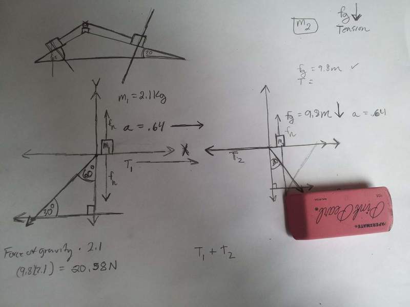

If the left hand slope makes a 60 degree angle and the right hand slope makes a 20 degree angle.
the left hand mass is 2.1 kg, and the right hand mass is unknown.
what would the right hand mass be given a downward acceleration of .64 m/s^2. ?
upslope at .76 m/s^2
I have set this problem up to the best of my knowledge and watched tons of videos but cannot grasp it. i think I am not breaking it up enough and i have a picture of my work and how i set it up.
thank you in advance for any help anyone may have to offer

call the tension T, and the unknown mass m,
and apply good ol' https://www.physicsforums.com/library.php?do=view_item&itemid=26" (F = ma) twice, once for each mass, in the direction of the slope …
that gives you two equations with two unknowns, so you can solve for m (and T) …
what do you get? :smile:

no, your F = ma equation must be for one mass only
do this slowly and logically …
first thing is to draw a https://www.physicsforums.com/library.php?do=view_item&itemid=100" with all the forces on it
(it must always be only for the forces on that body)
there are three forces on the right hand mass:
the weight 9.8m
the tension T
the normal force​
you know the acceleration parallel to the slope is 0.64
so now look at the diagram, work out what the component of the weight along the slope is, and write F = ma for that direction :wink:

this is what i have drawn out so far
no, your free body diagram for the right hand mass should be a slope at 20° with a little box on it
then three arrows from the box, one vertically down marked 9.8m, one along the slope marked T, and one perpendicular to the slope marked N
finally mark the acceleration of 0.64 down the slope (but don;t attach it to the box, and draw it differently from the forces, since it's not a force, so it shouldn't really be there! :wink:)
(and yes, it SHOULD be for one mass only)

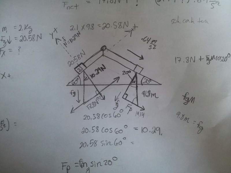

i didnt use f = ma for the left one. I thought that 20.58N * sin60 would give the force parallel to the slope
getting 17.83 and then 20.58 cos 60 = 10 . 29 N would the the normal force
so what... then i have ... Fnet = ma~
t1 + 20.58 + 10.29 = (2.1)(.64)
(all the forces?)
is that right? >.<? ( for the left )

ah, no …
you're fundamentally misunderstanding the vector nature of F = ma …
force and acceleration are both vectors, and F = ma is a vector equation …
that means you must choose a direction, and take components of F and of a in that direction
try it again, doing it in the direction of the slope :smile:
(btw, no need to call it T1, then two tensions are the same, so just call it T :wink:)

because you must use the components (along the slope), not the whole forces :redface:
there are three forces on the left hand mass:
the weight W, the normal force N, and the tension T
ok let's do this slowly and logically …
i] what is the component of W along the slope (up being +ve)?
ii] what is the component of N along the slope (up being +ve)?
iii] what is the component of T along the slope (up being +ve)? :smile:
