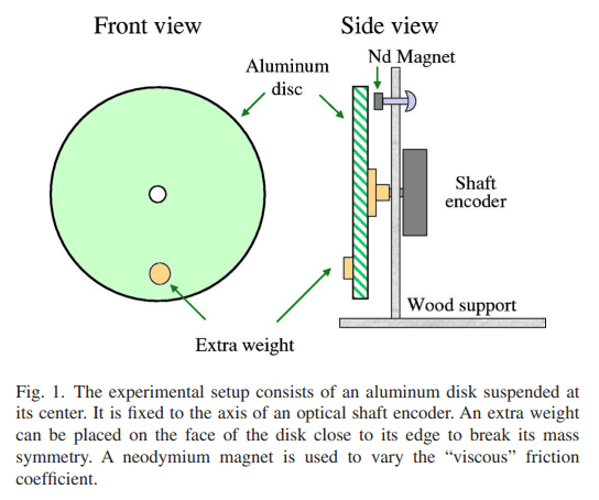

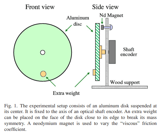

Hi all,
This is a question that has been bothering me and applies to kinetic sculptures.
Let's say you have a wheel. The wheel is situated in the vertical plane (like a clock hanging on the wall). For the sake of easy math, let's say the wheel has a radius of 1m, and has the entirety of it's 1kg mass evenly distributed about its circumference. You place a 1g weight at the11:00 position on the wheel. How long does it take the weight to cause the wheel to rotate such that the weight goes to the 1:00 position and then back to the 11:00 position (like a pendulum). Assume frictionless rotation.
Thank you for your responses!
Darren Chapman
Hello @dmcmd ,
:welcome: ##\qquad## !
Large ampltude pendula are mathematically tough customers. Your exact setup was analyzed by Salvador Gil; Andrés E. Legarreta; Daniel E. Di Gregorio here (Reference 12 in the wikipedia lemma).
(i used researchgate to get a sneaky peek -- not sure if PF allows this... ):
Working out the period is rather a daunting task !
