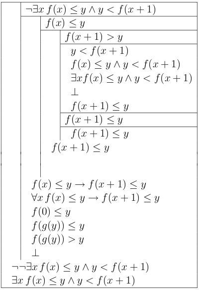

Consider the following claim.
Proposition (Integer Root). Suppose $f:\mathbb{N}\to\mathbb{N}$ is unbounded, i.e., there exists a
function $g$ such that $f(g(z))>z$ for all $z$. If $f(0)\le y$, then there exists an integer root of the equation $f(x)-y=0$, i.e., there exists an $x$ such that $f(x)\le y<f(x+1)$.
Proof. Towards contradiction, suppose no such $x$ exists. We prove by induction on $x$ that $f(x)\le y$. The base case is given. For the induction step, assume that $f(x)\le y$. If $y<f(x+1)$, then we have a contradiction with our assumption, so $f(x+1)\le y$, which concludes the induction step. Putting $x=g(y)$ we get $f(g(y))\le y$, contradicting the assumption that $f(g(y))>y$.
The following is a formal proof in Fitch notation.
The English proof above is rather detailed, so the formal proof has about the same size. In contrast, if the claim above were a part of a much more complicated proof, then it is likely that it would be dismissed as obvious.
Below is the statement of the theorem and its actual proof in the Coq proof assistant (the function S is the successor on natural numbers).

The proof is a written as a \(\lambda\)-term using a syntax close to the OCaml programming language. This proof contains all details (it relies on lemmas le_not_lt and le_or_lt, which were proved earlier). The computer has verified that it indeed proves the claim above according to the rules of mathematics programmed into Coq.
Unfortunately, the size of formal proofs and time required to write them is often significantly greater than the size and time associated with paper proofs. For example, pigeonhole principle is usually considered intuitively obvious and is rarely proved.
Proposition (Pigeonhole Principle). Suppose \(f:\mathbb{N}\to\mathbb{N}\) and \(n\ge 0\). If \(f(k)\le n\) for all \(0\le k\le n+1\), then there exist \(0\le k_1,k_2,\le n+1\) such that \(f(k_1)=f(k_2)\).
Formally, this statement is proved by induction on $n$. Further, from a formal proof it is possible to extract an algorithm that, given \(f\) and $n$, will find the required $k_1$ and $k_2$. That is, this algorithm is already implicitly contained in the proof. However, I would guess that for most people, writing such algorithm requires more thought that agreeing that the principle is true. This implies to me that formal proofs often contain details that authors of corresponding paper proofs don't think about.

My first sentence in post #2 says that mathematical logic provided a precise definition of a mathematical proof. By a formal proof, as opposed to an informal, or plain text, or paper, proof, I mean the concept that was thus defined. A formal proof is a mathematical object that usually takes the form of a sequence or a tree of formulas (which are strings of characters) built according to certain rules.

Sort of. A formal proof is not a means, but there are means to check whether a given sequence or tree of formulas is a correct formal proof. So, formal proofs make checking possible and even accessible to computers. Perhaps this statement needs qualification, but it is not clear that checking an informal, paper proof is a well-defined problem.
