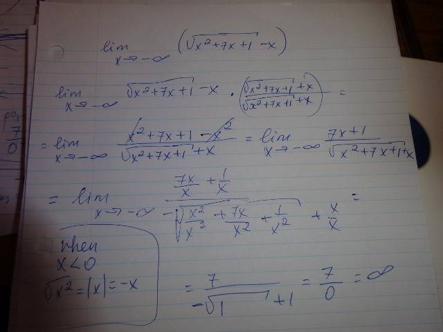

Hello,
sorry I tried to use Latex, but it didn't work...I uploaded picture of what I did instead.
I have a small question about the answer which is infinity why this is positive infinity? I know that correct answer is positive infinity, but I am trying to find explanation why...How do we know it is positive and not negative? Is it only because we are coming from the right side? I am very confused with this question. Also in which case there is negative infinity?
Thank you so much

Hello. Remember to enclose you latex with dollar signs or with the math tag.
So with regards to your question, take the limit of $\sqrt{x^2+7x+1}$ as x goes to $ -\infty$ and the same for x. You will find that the first is equal to $ \infty$ and the second to $- \infty$. Now go back to the original question. You have $\sqrt{x^2+7x+1}-x$. Plug in the solutions. $\infty - (- \infty)$ is equal to $\infty$. I hope that helps. That's the mathematical part. As for the conceptual part, I'll leave that to someone else who can explain better than me. :)
Another method to consider is to make the substitution:
$$u=-\frac{1}{x}$$
and our limit becomes:
$$\lim_{u\to0}\frac{\sqrt{u^2-7u+1}+1}{u}=\infty$$

Thank you so much! I was wandering what I am doing wrong with Latex lol
You said that x will go to negative infinity...is it because it has negative sign?
Thank you again for helping me. I know it is probably easy question, but I am very new to this...
What ineedhelpnow meant was that $\lim_{{x}\to{-\infty}}x=-\infty$. So (intuitively), $\lim_{{x}\to{-\infty}}\sqrt{x^2+7x+1}-x=\lim_{{x}\to{-\infty}}\sqrt{x^2+7x+1}-\lim_{{x}\to{-\infty}}x= \infty-(-\infty)=+\infty$.

Now, I just wanted to point something out here that was implied. Notice that for $u=-\frac{1}{x}$, $\lim_{{x}\to{-\infty}}-\frac{1}{x}=\lim_{{x}\to{\infty}}\frac{1}{x}$, which is tending to 0 from the positive side. Thus, in terms of $u$, we have $\lim_{{u}\to{0^+}}u$. So in fact, explicitely, we have $\lim_{u\to0^+}\frac{\sqrt{u^2-7u+1}+1}{u}$. Note that the top is always greater than 0, and $u>0$. A very large number over a very small positive number going to 0 is positive infinity.

Thank you so much, Rido12! It is all clear now!
Thank you, everyone for help!
