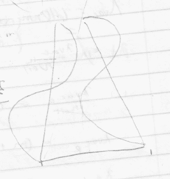

Why don't you post your drawing?
It's attached. :)

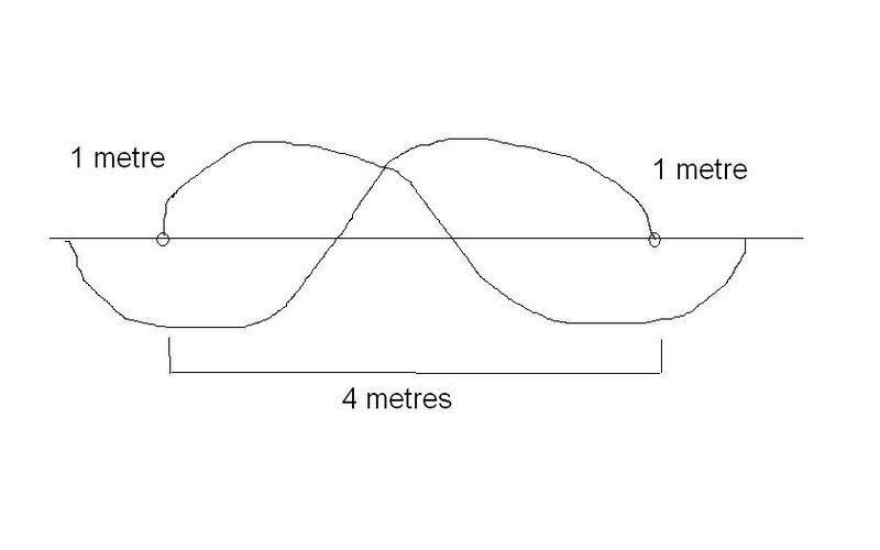

I see my explanation was not clear to you. Check this diagram out.

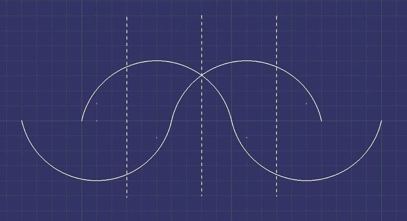

You already have the correct answers.
In the attached diagram the two wave trains meet and interfere constructively at the dotted line in the centre of the diagram. The other two vertical dotted lines which are one quarter of a wavelength away from the central line represent the locations of destructive interference.
Wavelength = 5m
One quarter wavelength = 1.25m
Central peak is at distance 2m
2m + 1.25m = 3.25m
2m - 1.25m = 0.75m
