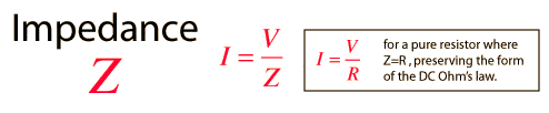

I have one more dount that in the same datasheet they have given operating impedance as 5600ohms. What does that mean?
Impedance is the ac equivalent of dc resistance.
http://hyperphysics.phy-astr.gsu.edu/hbase/electric/imped.html"
also see
http://en.wikipedia.org/wiki/Electrical_impedance"
