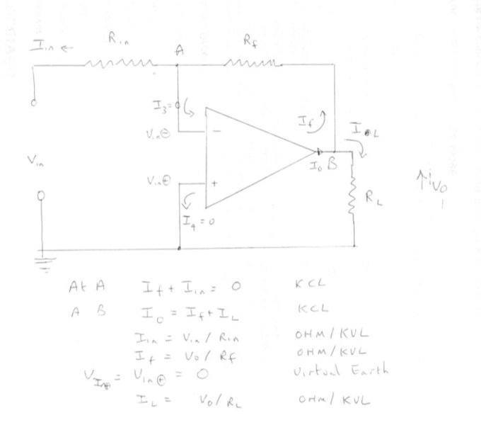

Good morning Red,
I am not used to the analysis presented in your book for op amps, perhaps you could post more detail, including a circuit of the application analysed?
Here is the version I am more used to which, as you say, considers KCL at two points.
  • Handwritten op amp inverting amplifier schematic with Rin, Rf, load RL, and KCL/Ohm's law equations at nodes A and B, including Vin, I_in, I_f, I_L and Vo.

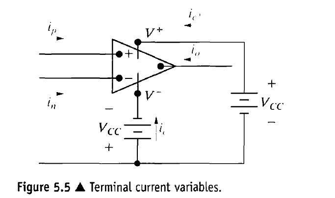

Hi
My question is a bit more general in that it includes the power sources. I attached the circuit for one of them.
Basically they did a "global" KCL equation for the whole Op Amp. They defined all five currents (inverting, non-inverting, output, and two voltage sources) associated with the Op Amp as positive entering the Op Amp and stated:
i_p_ + i_n_ + i_o_ + i_c+_ + i_c-_ = 0; basically sum of currents entering Op Amp is 0.
I was just wondering if KCL is valid for this case since in several books I consulted, they all say KCL is valid for a node but did not mention anything about for a component, but what tiny-tim said also makes sense given that an Op-Amp has no source of charge accumulation so based on charge conservation the currents should add to 0.
