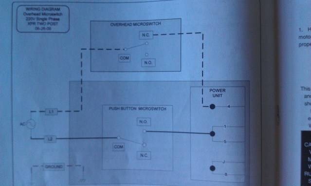

Im looking into getting an electrician... but it drives me crazy when I don't know why something is done a certain way.
I bought a Bendpak 10000 lb automotive lift. the motor supplied is 220 single phase or 3 phase (i am using single phase)
the motor for 220 single phase is supplied with a white, a black, and a green wire. The instructions call for 10 gauge wire up to this point with a 25 amp circuit breaker (double throw of course)
The wiring calls for 2 wires to be run approximately 14 feet with 14 (fourteen) gauge wire to a switch that is supposedly good for 15 amp.
The only way that i can see this working is with each leg grounding the other lead, that it is actually only considered 15 amp for each wave length (being out of phase for each other)
1. Is this correct in theory?
2. Also, being called 220 single phase... shouldn't this actually be called 2 phase?
I have man more questions.. but this is a good start
Your terminology is a bit off. Why are you bringing wavelengths into this? Without knowing what the 15 amp switch is controlling no one can give much of a comment. It is in fact single phase. This sort of thing has been discussed many times here on PF. A search should turn up something.
Is the switch actuated by a bar across the lift legs, so it will stop the motor if the top of the car hits it?
If so it is a safety switch to prevent lifting the car too high.
The reason for 10 awg wire up to the connection point is for inrush current. If you look at the nameplate of the motor,
the full load amps is probably around 18 to 20 amps.
As for why the switch is rated for 15 amps ? Are you sure it is 15 amps and not 20amps?
A model number or some specs would help.
Also it is a two POLE breaker, not two throw.

So far you both are right on. (I should not post things online when I am totally exhausted and ready to go to bed, I apologize)
Yes, the switch is for a cuttoff switch to make sure the lift doesn't damage the lift or the vehicle.
my understanding is that is cuts off supply to one of the leads and cuts off the ground to the other lead.
I had done a few searches online to try and find out, but nothing really fit (although I did not search this forum directly like I should have)
Actually, one discussion was on exactly this subject and same model even... but the answers given seemed to contradict each other.
The motor is 18 amp.
Model number xpr-10a

that discussion includes a basic mistake.
Uplift said
You are correct, the reason the switch and wire for the limit switch are rated for 15 amp is because you only have one leg of power running through the switch (1/2 of 30 amp circuit)
which is dead-*** wrong.
Current goes into the motor via one L wire and every bit of it comes back through the other L wire.
Everything should be sized so it's protected by the breaker. Switches included.
Caspian got it right a couple posts later on.
Thank you very much... after that thread in particular, I was very confused...
The safety switch(normally closed) goes in series with 1 leg of the power and 1 side of the motor.
The other leg of power goes to the push button. Nothing cuts off the ground!

ps I'm of the opinion that he should run both wires together , not separating them, to both switches.
something in NEC 300 about running wires together to avoid magnetic fields ?
clarification of my above post. this is like having two batteries in series. voltage is combined amperage stays the same. correct theory?

@jimhardy The safety switch is just a SO type cord (switch leg) from the point of power connection to the
switch and back. The power to the motor actually comes from the main connection point.

@jimhardy The safety switch is just a SO type cord (switch leg) from the point of power connection to the switch and back.
Ahhh okay, so long as it goes to switch and back...
