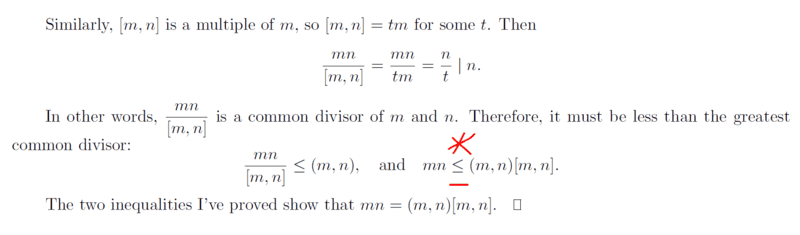

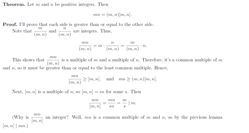

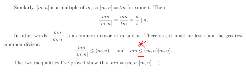

My interest is on the highlighted part ...
Now to my question,
in what cases do we have ##mn<(m,n)[m,n]?##
I was able to use my example say,
Let ##m=24## and ##n=30## for example, then
##[m,n]=120## and ##(m,n)=6## in this case we can verify that,
##720=6⋅120## implying that, ##mn≤ (m,n)[m,n]##.
chwala said:
Now to my question,
This is a strange question, in the very next line the finish the proof, that it is an equality.
I get your point the last line indicates an equal sign. However, ...the preceding line states that,
"Therefore, it must be less than the greatest common divisor'... on the contrary should it not be 'Therefore, it is equal to the greatest common divisor'? Unless there are cases where the inequality applies.

Now to my question,
Never. We have ##\geq## and ##\leq## making it ##=## and completing the proof.

The location with your red mark comes from ##a\leq b \Longrightarrow a\cdot c\leq b\cdot c## in case ##c\geq 0.## With ##a=\dfrac{mn}{[m,n]}\, , \,b=(m,n)## and ##c=[m,n]## we get what is written.

I can now see that two proofs that involve the inequalities ##[≤]## and ##[≥]## in general imply ##[=]##, thus concluding the proof. Clear now...
