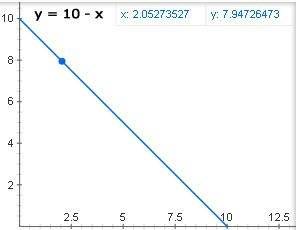

Consider a setup with one power supply and one resistor. Furthermore, you probably know that a wire has a resistance which is proportional to the length of the wire (see e.g. here; R = ρ*l/A; R = resistance, ρ = electrical resistivity, l = length, A = cross-section area)
Now, imagine that the resistor is actually a very long wire, that is
(+)-V1-|resistor|-V2-(-)
is equivalent to
(+)-V1-|--------Vp-------------------------------------|-V2-(-)
In this example Vp represents a measuring point that can be moved along the wire. First, let's define (-) as ground/earth, i.e. V2 = 0 V. We know that the current I will be I = V/R = (V1-V2)/R = V1/R. We also know that I will be constant (it's a DC setup), and that I will be the same at any point in the setup (it's a series setup).
Furthermore, we know that voltage is the difference between two potentials, and since V2 = 0 V, this means that the potential Vp at any point on the wire will be equal to the voltage between Vp and V2, that is (Vp-V2) = (Vp-0) = Vp.
Now, let's measure Vp at different points on the wire:
If you measure Vp close to V1, it will be Vp = V1.
If you measure Vp close to V2, it will be Vp = 0 V.
If you measure Vp at any point in between (from left to right), it will be linearly decreasing from V1 to 0 V (see graph example in attached picture below, y=Vp, x is proportional to distance; please note that this is only an illustration of linear decrease). E.g. if you measure Vp at half the length of the wire, Vp = (V1-V2)/2 = (V1-0)/2 = V1/2.
Furthermore, a variable resistor is similar to my example above; with a variable resistor Vp is connected to ground (V2) in my example;
(+)-V1-|--------Vp(-)-------------------------------------|
You can vary the resistance by adjusting the 'wire length' between V1 and Vp (longer length = more resistance = smaller current). Please note that in this example current will go from (+) to (-); there's no current going to the right of Vp.
It's really not more complicated than this. Please note that this example is meant to illustrate how you can view the voltage drop "inside" a resistor. Adding more resistors in series is equivalent to a longer total 'wire length' in my example, and the potentials between the resistors will be equivalent to certain fixed points at different positions on the total 'wire';
(+)-V1-|-------resistor 1-------Vp1-----resistor2-----Vp2---resistor 3---|-V2-(-)
(sorry for another long reply, but I'd rather be thorough than confusing, I hope I was successful :smile:)
