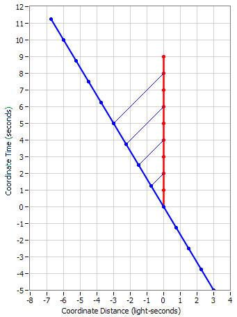

Let's do an example where the twins start off colocated and then one of them departs with a speed of 0.6c. At this speed, gamma is 1.25. I'm not going to try to interpret your formulas, instead, I'm going to advise you to stick with the Lorentz Transformations and to draw some spacetime diagrams which I will do here for you.
The first one shows the stationary observer in blue and the traveler in red. The dots represent one-second intervals of time for each twin. The question is, what do they actually observe? To show this, I draw in thin red lines to show the images of the traveler's clock ticking off one-second intervals of time:
As you can see, the stationary observer sees his own clock going twice as fast as the traveler's clock even though the traveler's clock takes 1.25 seconds of Coordinate Time to progress through each second of his Proper Time.

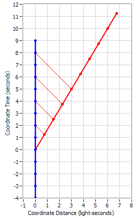

Now if we draw in what the traveler sees of the stationary clock, he sees his clock going twice the rate of the stationary clock but the Coordinate Times are still for the stationary observer:

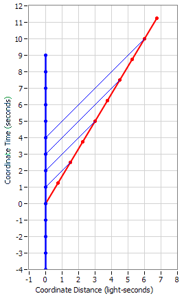

However, we can transform to the frame in which the traveler is at rest while he is traveling:
And now the Coordinate Times indicate the gamma effect for the traveler.

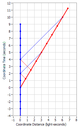

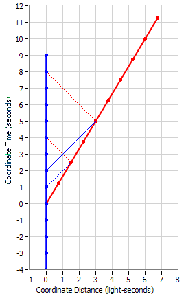

But this raises the question of how does each twin determine the gamma effect for the other twin? The answer is by using radar signals in which each twin sends a signal at the speed of light to the other twin which reflects off of him along with the time on the other twin's clock and when he sees these, he can assume that it took the same time for the radar signal to get to the other twin as it did for the signals to get back and from that he can calculate when the other twin's clock was at a particular time relative to his own clock. In other words, he averages the time he sent the radar signal with the time he received the reflection.
Here is a diagram to show the process for the stationary twin:
If you average 1 and 4, you get 2.5 as the time his twin's clock was at 2 and if you average 2 and 8, you get 5 as the time his twin's clock was at 4. This allows him to construct the same diagram that we are looking at so that he can determine the value of gamma.

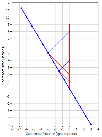

Similarly, the traveling twin can do the same thing and we can show it in the stationary observer's rest frame:
But we can also transform to the traveler's rest frame:
And now we see the Coordinate Times reflecting what the traveler calculated.
