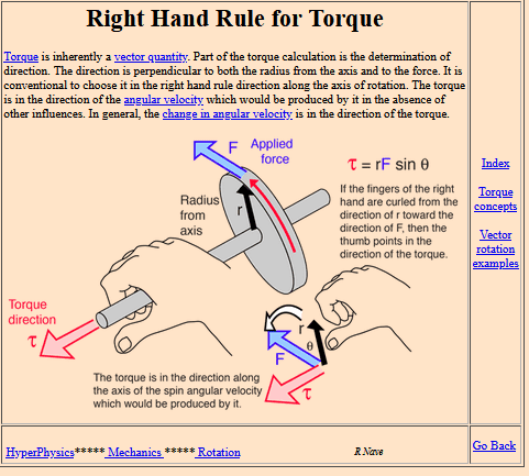

Have you learned about the use of vectors in general? How they involve a magnitude and direction (versus a scalar quantity that only has a magnitude)? Using vectors in math and physics equations usually simplifies the calculations (makes them more compact and intuitive), because they contain more information versus scalars.
For torque, one intuitively useful thing about the vector equation ##\vec \tau = \vec r \times \vec F## is that if the force vector and radius vector (radius out from the axis of the rotational torque) are at a right angle to each other and to the axis of rotation, that gives you the most torque possible for that force and lever arm length. If the force vector and the radius vector and the axis of rotation are not at right angles, the torque is diminished.
In the Hyperphysics note below, do you see how the force and radius vectors and the axis of rotation are at right angles to each other? That maximizes the usefulness of that force for generating the most torque that you can for the values of the force and radius length. If the force were pointing more backward a bit instead of at a right angle to the shaft, less torque would be transferred to the shaft. The equation that they show ## \tau = rF sin(\theta)## is the scalar version of the vector equation that I listed above.
Does that help at all?
http://hyperphysics.phy-astr.gsu.edu/hbase/tord.html

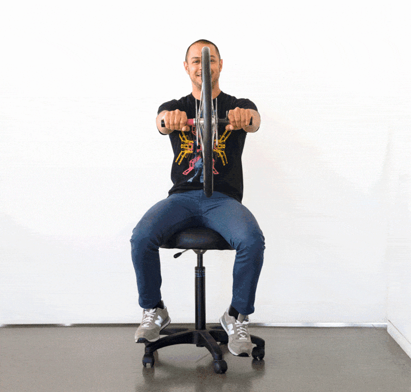

if professor do that (at 23:00min) staying on skateboard,will skate goes forwad,can he use gyro for linear motion?
When you steer your bicycle, the gyroscopic effect does not accelerate it forward or slow it down, the effect only helps you steering and leaning your bike.
Copied from
https://en.wikipedia.org/wiki/Bicycle_and_motorcycle_dynamics#Gyroscopic_effects
"The role of the gyroscopic effect in most bike designs is to help steer the front wheel into the direction of a lean. This phenomenon is called precession and the rate at which an object precesses is inversely proportional to its rate of spin.
Another contribution of gyroscopic effects is a roll moment generated by the front wheel during countersteering. For example, steering left causes a moment to the right. The moment is small compared to the moment generated by the out-tracking front wheel, but begins as soon as the rider applies torque to the handlebars and so can be helpful in motorcycle racing."
Note that the chair in this animation has wheels, which allow the chair to slightly move to compensate for the movement of the body of the subject; nevertheless, the chair does not slide (in any direction) during the precession of the wheel:
yes same will happened if men hold fan in hands,chair will roatate but not slide in any direction..
but if he stay on skateboard and hold fan in hands ,it will go forward
will it go forward with gyro if he point gyro in correct position?
Never forward movement, always rotation, as long as the spinning object has that degree of freedom (there is no restriction to rotate about that axis).
All rotating bodies “prefer” staying rotating on same plane.
If you or any torque force a rotating body to change from one plane of rotation to another, there is a “in protest” reaction, which is the reactive torque that we know as torque-induced gyroscopic precession.
Copied from
https://en.m.wikipedia.org/wiki/Precession#Torque-induced
“Torque-induced precession (gyroscopic precession) is the phenomenon in which the axis of a spinning object (e.g., a gyroscope) describes a cone in space when an external torque is applied to it. The phenomenon is commonly seen in a spinning toy top, but all rotating objects can undergo precession. If the speed of the rotation and the magnitude of the external torque are constant, the spin axis will move at right angles to the direction that would intuitively result from the external torque. In the case of a toy top, its weight is acting downwards from its center of mass and the normal force (reaction) of the ground is pushing up on it at the point of contact with the support. These two opposite forces produce a torque which causes the top to precess.”
ok so we can not use gyro as thrust/propulsion...:mad:
You could use a mechanism to convert the rotation into linear forward movement at the expense of slowing down the rotating object, which will reduce the gyroscopic effect.
The energy used to overcome the friction of that rotating man-chair (shown in above post) comes from the kinetic energy that the wheel initially had.
After a while both, the chair and the whell, will expend that energy, coming to a stop.
