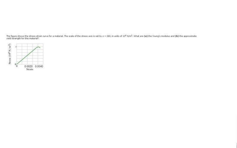

The figure shows the stress-strain curve for a material. The scale of the stress axis is set by s = 280, in units of 10^6 N/m2. What are (a) the Young's modulus and (b) the approximate yield strength for this material?
E=stress/strain
so i know that for part a i needa divide 280/.004 but I am not sure what it means to use units of 10^6. also shouldn't part b be 280? the unit that is correct is N/m^2 (its an online grading program that told me this is correct) and i cannot answer a 10^6 or any 10^... (the system won't read it) what am i not understanding?
It means that if you enter [answer] this will be interpreted as [answer] x 106 N/m2
e.g. if you put in 6 your answer will be interpreted as 6 Mega Pascals
so shouldn't the answer to part a be .07 n/m^2?
What are the units of the '280' ?
What does 280 / 0.004 equal? What are it's units?
280*10^6
so then the answer would be 7e10 but rly 7e4 bc of how the the program will interpret it?
rgold said:
280*10^6
You still didn't provide any units but yes you are on the right track.
280 MPa / 0.004 = 70 GPa = 70 000 MPa = 70 000 x 106 N / m2
so my final answer would be 70000e6 N/m^2 for part a and 250e6 N/m^2 for part b?
