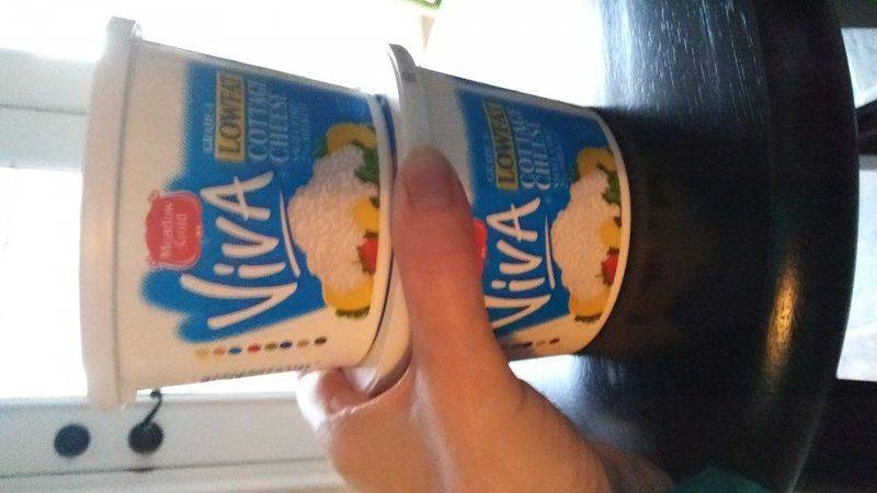

Hello,
I noticed something odd today while removing two identical tubs of cottage cheese from the fridge. They were stacked one on top of the other with no visual way to tell if a container was half full or completely full. When picking them up at the same time by only grasping "the lid of the bottom container," I felt that the bottom tub was more full than the tub on top. When I checked I found that I was right.
I decided to put the half full tub on the bottom and tried picking them up together again... only by grasping the lid of the bottom container. I could tell immediately that the tub on the bottom was lighter.
What was confusing wasn't how I was able to tell which tub was more full than the other with the two experiments, but why the total weight of the two tubs held together seemed lighter when the half full tub was on the bottom. I could have held it indefinitely without support. While when the heavy tub was on the bottom, it honestly felt as if I needed to eventually support my wrist.
Disregarding that it was merely psychological ...what would explain the total weight of both tubs seeming lighter only when holding the half full tub on the bottom?

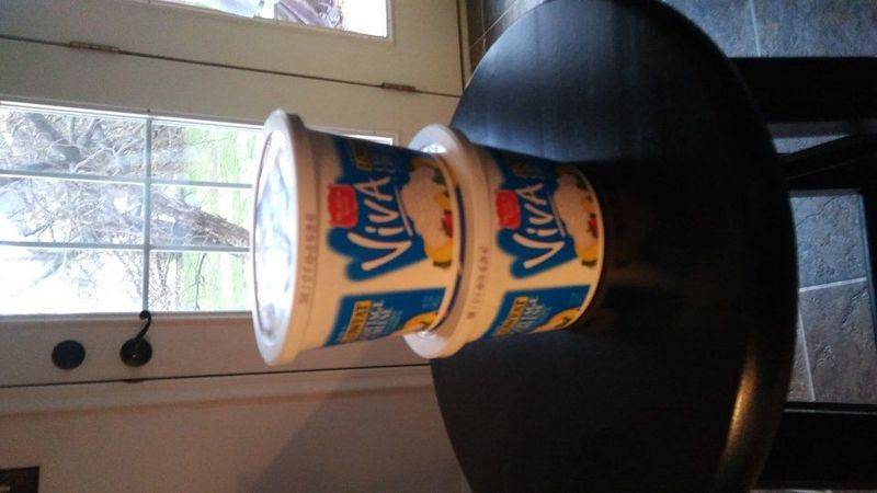

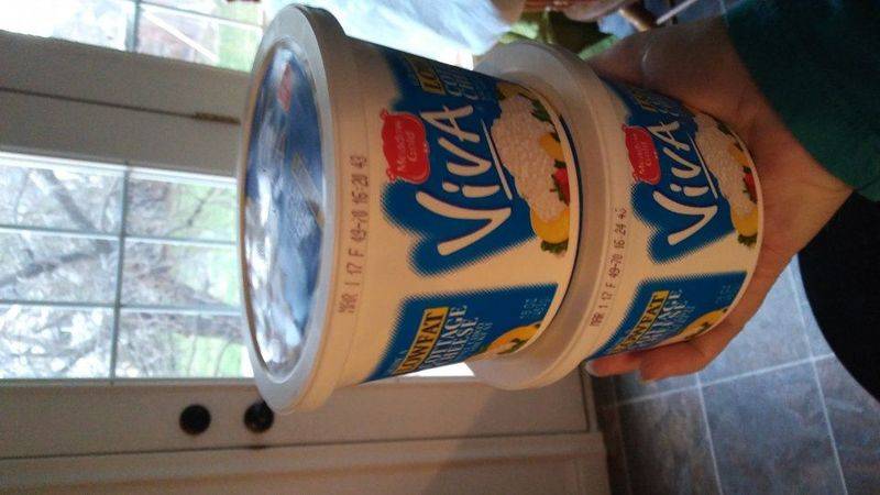

Sophicentaur and AT...
Thank you for your input. I have attached some pics to show the containers. Although seemingly large in the pics, they are only three inches high at best and not hard to hold...no sagging. My hands are small and I still easily can hold them by the lid of the bottom container.
What we tried was to, in a blind test, not only perceive the total weight by holding the tubs by the lid in the middle, but also by placing the two tubs in the palm of our hands. The results were the same that with the half full tub on the bottom, the over all weight was perceived to be less than with the half full tub on the top. I visually noticed the tendons pop up on my daughter's arm when trying told hold the tubs with the full one on the bottom. This did not happen with the reverse of that experiment.
Thank you in advance for any insight you can add.
