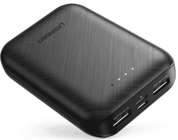

When I go camping, I bring an inexpensive battery pack to charge USB devices. It has two output ports, 1A and 2A.
The surface connect to type c costs $80 so I guess I'll just use a battery pack like above as suggested.
Now for permanent use. Won't the battery pack like the above be safer to use than an AC (Alternating Current connected directly to transmission line) adaptor like this?
I mean, can't any defect happens (like open or short in the wiring in the primary winding inside) the can cause secondary to have full 110 voltage instead of 5 volts? So won't a battery pack just be safer to use? As the worse that can happen in the latter is just 9 volts going to output instead of 5 volts?

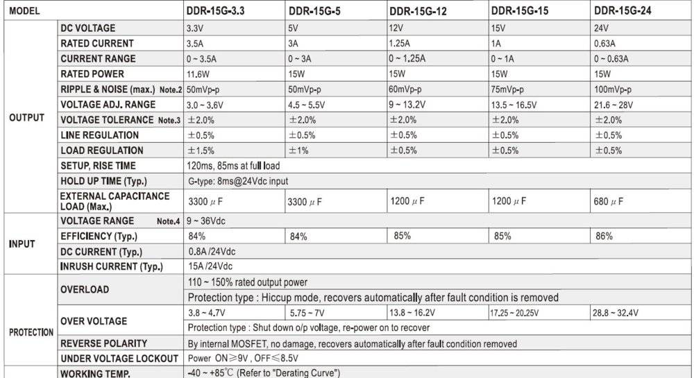

You are right. But which is safer to use on a very expensive laboratory equipment for permanent lab setting (to protect the investment). A DC/AC switching adaptor or a 12v battery and 12vto 5 v DC converter like the following:
https://www.meanwell.com/webapp/product/search.aspx?prod=DDR-15
click image to enlarge it

They are equally unlikely to cause an over-voltage problem.
It is 100 times more likely that expensive equipment will be stolen.

But technically. The DC to DC converter would be more safe because in the even the converter is damaged, the overvoltage would only be 9V or 12V (the battery) instead of full 110 volts. In average use. You are right that it is 100 times more likely it would be stolen.
But it would matter if it would be used as a tactical equipment, to detect chemical warfare residue or explosive traces. In such case then the DC to DC converter would be more appropriate. Correct? Not that I'll use it on them but just asking. And all spectrometers are controlled for export to North Korea because they have military use too.
HUH ?? where did you get the 110V from in a DC - DC converter ??

No.
110 Vrms AC is rectified to 155 V DC. We still have 240 Vrms which gives 340 V DC. I have been designing, building and servicing switching supplies for over 40 years. A failure in the HV circuit has always blown the fuse, sometimes it has shattered semiconductors, but it has never jumped to the isolated low voltage output.
On the other hand, a DC-DC converter is usually not isolated. A short circuited switch failure is more likely to connect the input voltage to the output through the inductor. That over-voltage should be detected by a crowbar circuit which will short the output and so protect the load, quickly blowing the fuse.
https://en.wikipedia.org/wiki/Crowbar_(circuit)
Which may be just as destructive depending on the equipment as 115VAC.
Meanwell DDR ones are.
If you are still concerned, get a medical power supply with a cardiac float rating.
https://recom-power.com/en/applications/medical/medical-power-supplies.html?0
You can literally bet your life on that not frying the equipment.

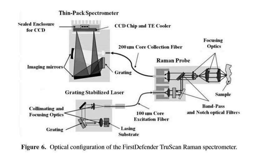

Btw. the Spectrometer I have is mostly optics. The only components that need the 5V is the laser and CCD. The laser can be replaced by a hole at the side of the unit. Does anyone know what kind of CCD has this spec?
Linear CCD ArrayLinear CCD Array
Pixel Number3648
Pixel Size8 μm x 200 μм
Dark Current630 e/pixel/s
Readout Noise30 e rms
Dynamic Range2100
Max Quantum Efficiency90%
Integration Time10 ms – 500000 ms
This is what composes a raman spectrometer (mine doesn't have a TE cooler or any fiber optics, the one below costs $65,000). Can you make the components less than $16,000? I think my supplier can assemble them for less than $1,000. What is your opinion? Note the software is only one time deal for all their products. It's like Apple creationg the IOS for all Iphones units and not each individually programmed.

If the spectrometer is that expensive then why not spend a bit more money and use the manufacturer's recommended supply unit? If you are really worried about what could happen when there is a power supply fault then read the bit in the manual which tells you about the warrantee being void if you don't use the right PSU.
