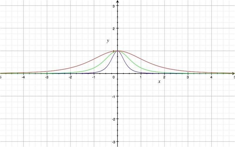

Why am I finding the maximum not it's width?! Surely the maximum value of the function is at k=0. I thought I have to find something like the full width at half maximum.
I'm confused now as to what I'm meant to be trying to do.
I never would have suggested you plot this function if I knew how difficult this was going to be. Let's just forget plotting the function and take a different tack.

I've attached plots of |phi(k)|2 for three different values of alpha. I normalized them so they have the same maximum to make them easier to compare. The red, green, and blue curves correspond, respectively, to values of alpha equal to 2, 1, and 1/2.

Well, doesn't [tex]|\phi(k)|^2}[/tex] give the 'spread' of the momentum of the particle, and the momentum is just given by: [tex]p=\hbar k[/tex].
No, [itex]|\phi(k)|^2 dk[/itex] is the probability that the particle has a momentum between k and k+dk.
Thanks for the graph, it is very useful, I now get that varying the value of [tex]\alpha[/tex] changes the shape of the [tex]|\phi(k)|^2}[/tex] curve, or rather more specifically changes the width of the peak.
So going back to the question, which is to find a characteristic width, which is the distance between either side of [tex]k=0[/tex] where the curve stops 'rapidly decreasing'.
Since the function/curve is symmetric, then just need to consider one side and determine the value at which the function stops 'rapidly decreasing'? It is finding this that I do not understand how to do. I thought maybe when [tex]\alpha = k[/tex], or something like that. I really don't get what to do.
OK, so you've seen that the value of [itex]\alpha[/itex] affects the width of the peak. Now how would you say it does that? For example, does the width vary linearly with [itex]\alpha[/itex]? Is it 10 times [itex]\alpha[/itex]? You're not looking for an exact answer, but just a good enough description of how the width depends on [itex]\alpha[/itex].
Take a look at the graphs again. Let's somewhat arbitrarily though reasonably say the peak is defined between the points where the curve falls to 1/4 its maximum value. What are the widths you get for the three curves and how are they related to the [itex]\alpha[/itex] for each curve?
Considering the graph..
For the blue line, the value of 1/4 of the curve height is at 1/2, and this blue line corresponds to alpha = 1/2.
For the green line, the value of 1/4 of the curve height is at 1, and this blue line corresponds to alpha = 1.
For the red line, the value of 1/4 of the curve height is at 2, and this blue line corresponds to alpha = 2.
.. so the width are directly related to alpha?
Yup, and you can see this from the function. The k appears only in the denominator [itex]k^2+\alpha^2[/itex]. When you say "k is small," you mean k2 is small compared to [itex]\alpha^2[/itex], that is, [itex]k^2/\alpha^2 << 1[/itex]. Similarly, when you say k is big, you mean [itex]k^2/\alpha^2 >> 1[/itex]. When k is small or k is big, we know the function doesn't change rapidly. The function changes rapidly in between, namely when [itex]k^2/\alpha^2 \approx 1[/itex], i.e. when [itex]|k| \approx \alpha[/itex].
