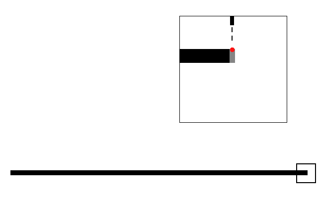

No I wasn't actually thinking of using electricity as the medium but the actual physical object that is the steel beam.
Pretty bad example image, but basically using a sensor to detect if the beam is in front of it would be the encoding(from the "analog" medium to digital). Just speaking plainly, if I were to push on the beam and have it move on the other end, would it trigger at the same(faster/slower?) speed as if I sent a signal over the fiber?I know I posted under the "electrical" forum, but my intent wasn't to use the steel beam for electrical data transfer but actually using the physical beam as the medium.
Instead of shooting a photon or pushing electrons, would it be faster to push the actual object's atoms?
I suspect not. If you intend to move the beam itself, there is inertia to overcome. And solids don't support compression waves the way gasses do. There are two distinct ways of doing what you are describing; Pushing the whole beam back and forth, and sending some form of compression wave down the beam. One is no go, the other is a slight maybe, you would really have to experiment. But the question as to speed, the light fiber travels very close to the speed of light, so it seems pretty unlikely that if you are not using electricity, any other form of compression wave would be waaaaaay slower.

@Averagesupernova nailed the answer, any compression wave traveling through an object is limited by the speed of sound within that object. The speed of sound in steel is ~6km/s, which is 50,000x slower than fiber optic cable.
A similar question that often comes up is whether or not pushing and pulling a long rod will send information faster than light, it won't and we have an FAQ on why:
https://www.physicsforums.com/insights/can-i-send-a-signal-faster-than-light-by-pushing-a-rigid-rod/
