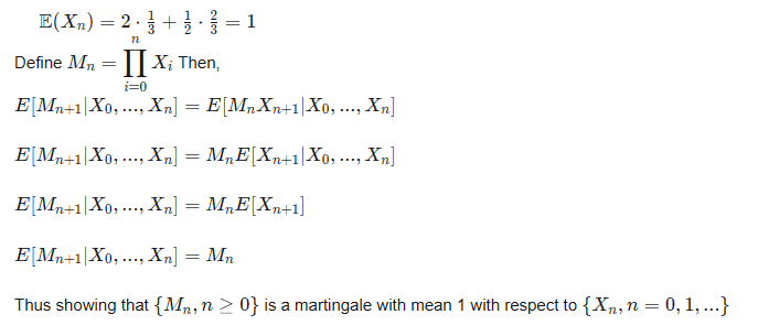

Answer to 1.

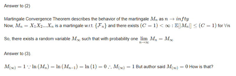

Answer to 2.

Office_Shredder said:
Why does ##ln(M_n)=ln(M_{n-1})##?
Sorry, if ##\log{M_n} =0, \log{M_{n-1}}=\frac13 \log{2}## or ##\frac23 \log{\frac12}##
Whatever it may be, we can't say ## M_{\infty} =0 ##
This feels like you're looking backwards - why are you computing what ##\log(M_{n-1})## ?
What is ##E(\log(M_{n+1})-\log(M_n))##
##(\log\{E[M_{n+1}]=1\} -\log\{E[M_n=1]\}) = 0-0 =0##
The expected value of log of ##M_n## s not 1. Your answer for part three is wrong, the book is right. Try computing that expected value from the definition.

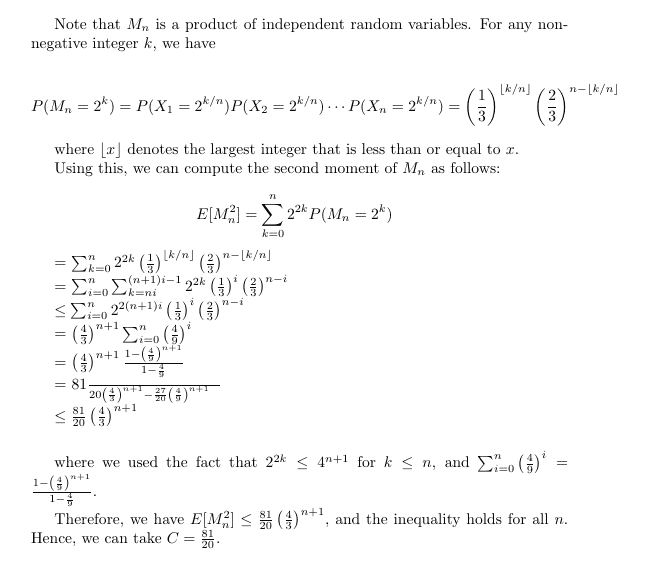

Answer to 5.
Yes. There exists a ##(C < \infty ): \mathbb{E} [M^2_n]\leq C \forall n ##

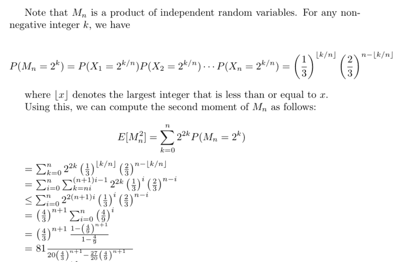

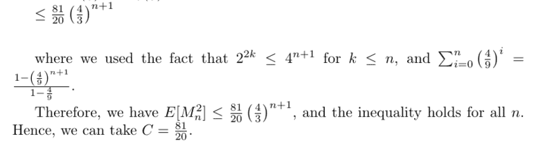

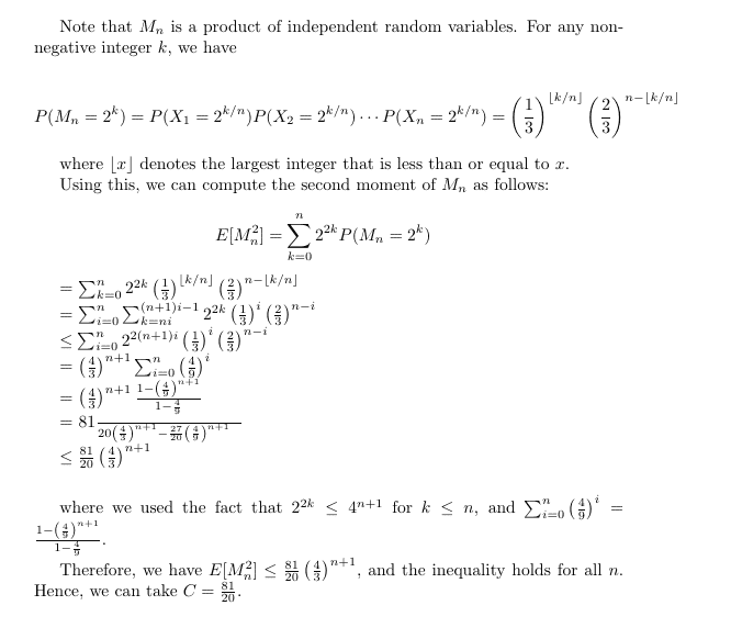

Answer to 5.
Is the above answer correct?
Note: This answer is provided to me by Chat.G.P.T.
I don't understand this answer from second step onwards. If this is the correct answer, would any member explain me this answer?

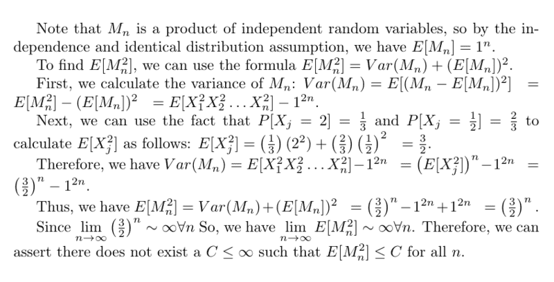

I don't agree with chatgpt's answer given by me in #15.
My own computed answer is as follows:
Is my answer correct?
