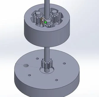

i want to use 1 motor to turn the shaft. lets say shaft turns clockvise, there is two discs on shaft. discs have to turn same speed reversed rotation. i drawed reverse clockwise motion. it is 1:5 slower than shaft. when i drawed other disc (rotates clockwise like motor) it turns speed of shaft so 5x speed.
Hi guys, i want to build small vision show i will use lasers. But stucked at the mechanics. i want to use 1 motor to turn the shaft. lets say shaft turns clockvise, there is two discs on shaft. discs have to turn same speed reversed rotation. i drawed reverse clockwise motion. it is 1:5 slower than shaft. when i drawed other disc (rotates clockwise like motor) it turns speed of shaft so 5x speed.
i will arrange this discs like clockwise, reversed clockwise, clockwise, reversed clockwise, .. 6-10 piece of discs.
My question is how can i do below disc to turn with same speed of reversed rotation disc?
Further question if you want to more helpful, Kindly i want to make this cost effective and durable am i going to right way?
Video of reversed; Top is reversed disc. below is not drawed.

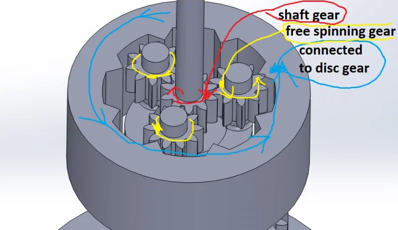

I guess I did as you said? I explained the mechanism in the picture below. The gear (red) connected to the shaft only turns the gear (yellow) that rotates on its own axis. I put 3 of these gears, it would have been one too. Then this gear turns the internal gear (blue). But since the internal gear has to have many teeth, it turns slower.
What you have designed is a planetary gearbox. They’re delightful for changing speeds, but not so much for changing directions while maintaining the same speed.
You will want to use a bevel gear setup, tbh. Have one disc mounted directly to the motor shaft, using a mounting bracket with an angled/bevel gear on it. Use 2 bevel gears as idlers between the discs, and mount them on a yoke or collar that carries a bearing, mounts to the platform, and holds the shaft steady. This also locks the idlers in relative position to the two discs and prevents them from drifting. Finally, mount the second disc on a bearing with an adapter to match the bevel gear found on the first disc. This should allow the discs to match speeds, but in opposite directions.
The other option would be rollers between the discs, also on a yoke or collar setup, again to keep them from moving around the drive axle.
I hope this makes sense.
