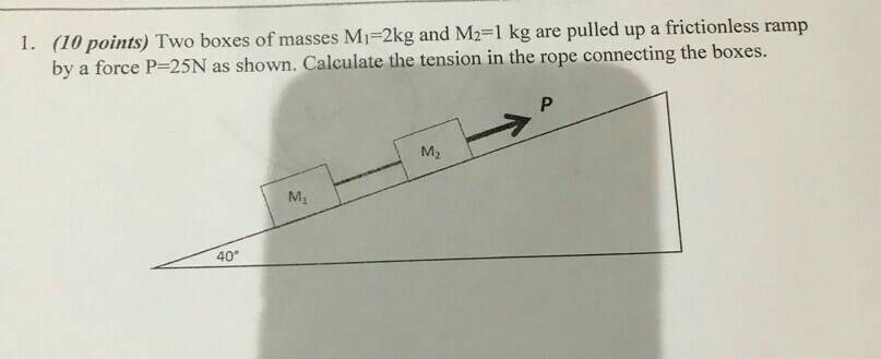

Two boxes of masses M1= 2kg and M2 = 1 kg are pulled up a frictionless ramp by a force P=25N. Calculate the tension in the rope connecting the boxes. Theta is 40 degrees.
F = m* a

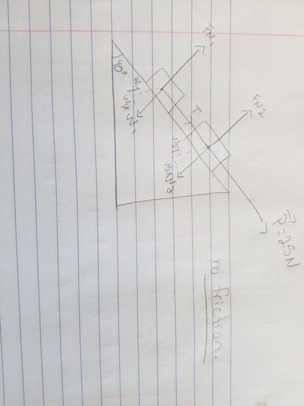

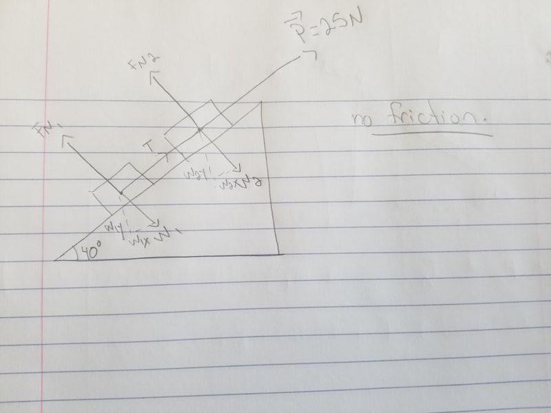

Hi guys, I feel that this question has a very straightforward answer but I am just not quite grasping it. The first picture is the homework question, the second is the free body diagram I drew.
I know that a = F/m and I know the solution should be:
a = (P - m1*gsinθ - m2*gsinθ) / m1 + m2
What I don't understand is why isn't tension (T) included in the above equation? It's clearly along the x-axis with the others and P is used, so why not tension as well?
The equation that seems logical to me to use is:
a = (T + P - m1*gsingθ - m2*gsingθ ) / m1 + m2
but this is wrong. Can you help me understand why T doesn't belong?
Thank you in advance!

The tension acts on both objects not just on one of them. It is an internal force if you consider the system of the two objects.
If you we’re doing a force balance on each body individually, the tension T would come into each of the force balances. What would those two force balance equations be?

The given solution treats the two boxes along with the connecting rope as one object.
By the way: the sum of the masses, m1 + m2, should be enclosed in parentheses if you mean for it all to be in the denominator as in the following.
a = (P - m1⋅g⋅sinθ - m2⋅g⋅sinθ) / (m1 + m2)
This acceleration can then be used to determine the tension, T .
If you want to use your second image for free body diagrams,
242890
you are missing that the rope also exerts a tension, T, on the box of mass, m2 . (Yes, then what you have would be two free body diagrams in one image.) You get two equations, one for each box.
