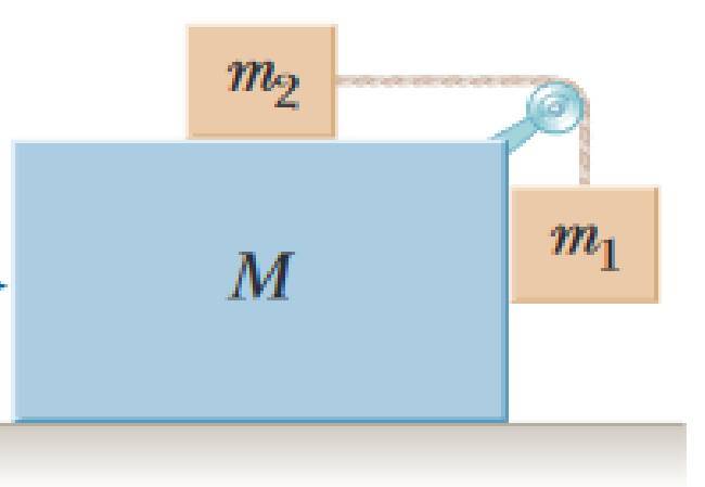

Can anyone please explain to me how can I calculate the "Tension" and "acceleration" of M in this question interms of M,m1,m2 and g?
I can't understand how M has an acceleration or why M is involved in the calculation of the tension
my solution was that acc of M is zero
and Tension = m1g x (m2/(m2+m1))
Thanks in advance :oldsmile:

What is the tension in the rope (assuming M is not moving)? From a free body diagram of M (including the attached pulley), what are the forces acting on M?

The question does assume one external force in particular. But leave that to one side. What internal forces act on M?

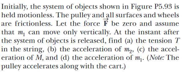

Printed problem text: Initially the system in Figure P5.93 is held motionless; pulley, surfaces and wheels are frictionless; F is zero; m1 moves only vertically; find tension T, accelerations of m2, M and m1 just after release.
Figure P5.93: block of mass M on a frictionless-looking floor pushed by force F to the right; m2 rests on top of M, connected by a string over a pulley at the top-right corner to m1 hanging beside the block's right side.

The question was addressed to you, not to the textbook. You should be able to draw a set of free body diagrams, one for each object in the system. The question at hand is about the forces that act on M.

Yes, you have quoted the problem from the textbook. Yes, that is the problem that you are trying to solve. But you have been asked a question several times now about an inventory of forces that act on M. We are not asking for a numerical answer. We are just looking for you to identify those forces so that you could portray them in a free body diagram.
The goal is to be able to write equations that relate the various forces and accelerations that you identify. The first step is to identify the forces.

There are other forces. If M is accelerating to the right what about m1?
What about m2?

It is good that we are no longer talking at cross purposes. Yes, M's own weight and the normal force from the table on which it rests are two things that act on M. There are others. Consider, for instance, block m2. Does it exert any force on M?
But your primary concern is with tension and how it relates to M. Let us look more closely at that. Consider the pulley. What forces act on the pulley?

That's close. I am going to spoon feed you this part of the answer.
You have the tension from the rope segment leading off to the left. That results in a leftward force on the pulley. You have the tension from the rope segment leading down to m1. That results in a downward force on the pulley. You have the force from the attachment of the pulley to M.
Strictly speaking, "tension" is more a condition in a rope than it is an actual force. Tension results in a force at its point of attachment. That force is equal to the magnitude of the tension. It acts on the attachment point and has a direction pointed from the attachment point along the direction of the rope.
For an ideal pulley, the tension on the rope segment coming off on the one side is equal to the tension in the rope going in the other. However, those directions are almost always different, so pulleys are almost always under a net force due to the tension. You can treat a pulley as if the rope is "attached" to the pulley wheel at two points, one where it goes in and the other where it comes out.

then the other force acting on M = the resultant of the two forces acting on the pulley ?
Yes.

The reason you are having so much trouble with this problem is that you have not drawn a free body diagram for the combination of M together with its attached pulley. Do you really feel that you have advanced to the point where you no longer need to use free body diagrams?
