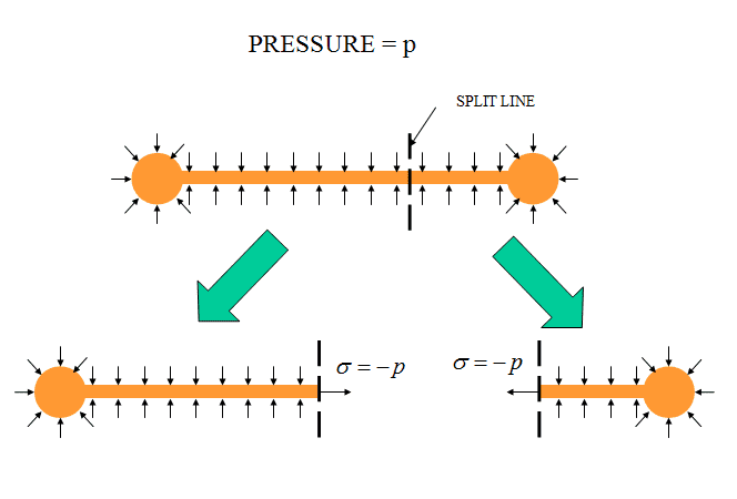

  • #61
Chestermiller said:
You're correct that the pressure forces normal to the cylindrical surfaces of the noodle don't affect things. It is only the pressure forces on the free ends that play a role.
I like your fluid mechanics explanation better than that!
As you indicated in another post, the small area of the free ends makes the net forces on them negligible.
We can think of the rod as a piece of uncooked spaghetti. Suppose the free end of the spaghetti that is outside the person's mouth is pressed against a wall so there is no air between it and and the wall. There is no air pressure on that end. Will the person be able to suck the spaghetti into his mouth? (I don't claim to know.)

It seems to me that the effects of "pressure" aren't easily analyzed as set of vectors.
Well that's just it, isn't it? Pressure is the isotropic part of the stress tensor. Stress is a tensor quantity that expresses more than just pressure. Shear stress can't easily be formulated in terms of a vector- at least not in any useful way.

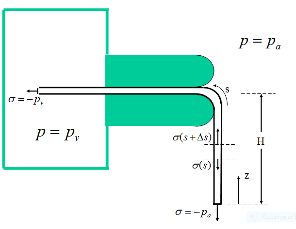

Over the past several days, I have spent lots of time thinking about this problem, and I would like to present what I have come up with. My focus has been on addressing the questions that @Stephen Tashi has been asking, and on using a solid mechanics approach of the type that @Andy Resnick has been recommending.
The analysis considers a cooked spaghetti noodle, and neglects its bending stiffness; so it is treated as being very flexible. The component of the gravitational force perpendicular to the noodle axis is neglected, but the component of the gravitational force tangent to the noodle contour is included. So the stresses in the noodle do not vary over its cross section. The force balance on the noodle is confined to consideration only of the tension and stress variations in the direction tangent to the noodle contour.
The principal stresses are locally approximated as being oriented in the tangential (axial) direction ##\sigma_z##, the radial direction ##\sigma_r##, and the hoop direction ##\sigma_{\theta}##. We employ Hooke's law in 3D to describe the deformational behavior of the noodle material, and to analyze the state of stress and strain in the noodle:$$\epsilon_z=\frac{\sigma_z-\nu(\sigma_r+\sigma_{\theta})}{E}$$
$$\epsilon_r=\frac{\sigma_r-\nu(\sigma_z+\sigma_{\theta})}{E}$$
$$\epsilon_{\theta}=\frac{\sigma_{\theta}-\nu(\sigma_r+\sigma_{z})}{E}$$where ##\nu## is the Poisson ratio and E is the Young's modulus. In our system, because of cross sectional symmetry, the cross sectional stress distribution will be transversely isotropic, such that $$\sigma_{\theta}=\sigma_r$$ and $$\epsilon_{\theta}=\epsilon_r$$ This enables us to eliminate the hoop stress and hoop strain from the analysis to obtain:
$$\epsilon_z=\frac{\sigma_z-2\nu\sigma_r}{E}$$
$$\epsilon_r=\frac{(1-\nu)\sigma_r-\nu\sigma_z}{E}$$
I've used the following diagram to analyze the problem:
The room atmospheric pressure outside the mouth is ##P_a##, and the reduced pressure inside the mouth is ##P_v<P_a##. So the pressure difference ##P_a-P_v## supports the component of the noodle weight tangent to the noodle contour.
Four sections of the noodle are identified in the figure. Section AB is entirely within the mouth, and does not support any weight; the pressure acting on the surface of the noodle is isotropic and uniform at ##P_v## in this section. Section DE is outside the mouth and is oriented vertically; the tension in the noodle varies axially in this region, although the pressure on the external noodle surface does not vary from ##P_a##. Section CD is also outside the mouth, and is contact with the lower lip (but not the upper lip); so the contour is curved, and only a fraction of gravitational force acts tangent to the contour. In section BC, the noodle is in contact with both lips, and the pressure on the noodle surface varies from ##P_a## at location C to ##P_v## at location B.
I think I'll stop here for now and continue in my next post. Please let me know if you prefer for me to analyze this problem in terms of absolute pressure and stresses, or in terms of absolute pressures and stresses.

Consider dry lubricants- graphite powder, for example. That's a real-life version of dry water, so we eliminated your odd insistence that the fluid can be abstracted away. And indeed, even though the powder acts as a fluidized bed, the viscosity is very low- let's go with your simplification of a frictionless interface- and make it zero viscosity. We physicists could also suggest using superfluid He, but there's the non-simple problem of what happens if you aspirated liquid He.
Now what happens? Most likely, you can't suck up the noodle- unless you are an astronaut orbiting the Earth (as you also suggested), because then the tiny ΔP will indeed create an imbalanced force, and you could indeed aspirate the noodle. [Edit]: a frictionless interface means the noodle will move freely under any imbalanced, momentary axial force and the housing cannot arrest the motion. So the device must be in free-fall (true free-fall, not attached to an orbiting craft).
[Edit]: So, by removing viscosity, your simplified problem does not describe a broadly applicable class of behavior, it is actually restricted to a highly specific (and useless) physical situation.

Now consider the flaccid noodle, with the apperture having frictionless lubricant. Being frictionless, it cannot exert any force on the noodle by flowing. Yet, I believe, in such a case, the noodle would still be sucked in - very fast. As an approach to understanding this, consider replacing the noodle with a long balloon at above standard pressure, standard pressure on one side of the apperture, and vacuum on the other. The balloon would be sucked in by expansion on the vacuum side pulling the other side in by tension and flow of the balloon material. Now, get from here to a more plausible model of a noodle. I am thinking the noodle effectively flows in, and boundary flow is irrelevant or secondary in nature.
  • #86
Again, without friction, you could not maintain the tensile stress difference in the balloon between inside and outside the mouth without an unrealistically huge acceleration of the balloon. In the case of a limp noodle, the same basic principle applies. The tensile stress difference can only be maintained by acceleration of the noodle or by friction at the surface of the aperture.
