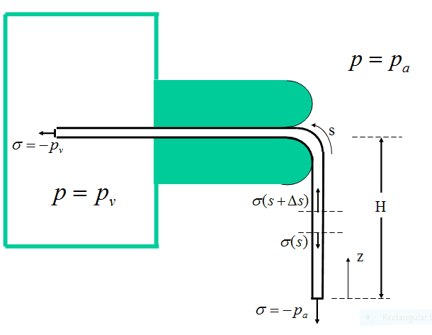

The figure below shows a schematic for the Limp Noodle case. This is the situation we will be analyzing.
The noodle extends from inside the mouth, through the lips, over the lower lip, and then dangles vertically downward. The pressure outside the mouth is atmospheric pressure ##p_a##, and the pressure inside the mouth is ##p_v<p_a##. Both pressures act strictly perpendicular to surfaces that they contact.
Now let's consider the state of stress within the noodle. In this development, we will be working with absolute pressures and stresses, rather than gauge pressures and gauge stresses. We also adopt the usual sign convention that tensile stresses are regarded as positive and compressive stresses are regarded as negative.
Inside the mouth, the noodle is in a state of isotropic compression throughout, caused by the surrounding air at pressure ##p_v##. Both the radial and axial components of tensile stress within the noodle are equal to ##-p_v##. In the figure, only the axial component of tensile stress is shown. We use the symbol ##\sigma## to represent the axial component of tensile stress in our analysis. So, ##\sigma=-p_v## for the entire portion of the noodle inside the mouth.
Outside the mouth, the axial tensile stress within the noodle varies with elevation z in order to support the weight of the noodle. However, at the very bottom of the noodle at zero elevation (z = 0), the axial tensile stress is equal to ##\sigma =-p_a##, because the noodle is in contact with room air acting normal to its bottom surface.
We will next carry out a differential force balance on the noodle to quantify how the axial tensile stress ##\sigma## within the noodle varies along the contour coordinate s (see figure); the contour coordinate s is the cumulative distance measured along noodle contour, starting at the very bottom of the noodle.
In this development, we treat the noodle in the same manner that we frequently treat ropes in many mechanics problems. The bending rigidity of the noodle is neglected, and the primary focus of the force balance is in the tangential direction along the noodle contour; the forces acting normal to the contour (e.g., at the bottom lip) are of less interest here, and are not considered. Unlike mechanics problems, the weight of the noodle is included in the force balance. Our objective is to determine the minimum pressure difference required to just support the weight of the noodle, such that the noodle will be in static equilibrium. Any additional pressure difference will cause the noodle to accelerate along the contour into the mouth.
If we perform a differential force balance in the tangential direction on the section of noodle between contour locations ##s## and ##s+\Delta s## (see figure), we obtain: $$A[\sigma(s+\Delta s)-\sigma(s)]=(\rho A \Delta s)\left(g\frac{dz}{ds}\right)\tag{1}$$where A is the cross sectional area of the noodle, ##\rho A \Delta s## is the mass of noodle between contour locations ##s## and ##s+\Delta s##, ##\rho## is the density of the noodle, and ##g\frac{dz}{ds}## is the component of gravity in the local tangential direction along the contour. If we divide Eqn. 1 by A##\Delta s## and take the limit as ##\Delta s## approaches zero, we obtain:$$\frac{d\sigma}{ds}=\rho g\frac{dz}{ds}\tag{2}$$This equation can immediately be integrated between the two ends of the noodle (subject to the boundary conditions on ##\sigma##) to yield:
$$-p_v+p_a=\rho g H\tag{3}$$where H is the maximum elevation of the noodle (relative to the bottom of the dangling portion, see the figure). Therefore, for static equilibrium of the noodle, $$\Delta p=(p_a-p_v)=\rho g H\tag{4}$$
This completes the description on how to determine the pressure difference required for the Limp Noodle case.

Chestermiller said:
The figure below shows a schematic for the Limp Noodle case. This is the situation we will be analyzing.View attachment 111083

Chestermiller said:
The figure below shows a schematic for the Limp Noodle case. This is the situation we will be analyzing.Therefore, for static equilibrium of the noodle, $$\Delta p=(p_a-p_v)=\rho g H\tag{4}$$
That makes sense- it's the same hydrostatic pressure required to draw a 'fluid rope' up a height H. Nice!

Andy Resnick said:
With all due respect, this is silly
All physical models are silly in the sense of omitting details. For example, it's "silly" to model friction in a practical situation as a constant force. Textbook problems in elementary mechanics (which frequently involving frictionless contact) are silly in that sense. The interesting question, to me, whether elementary mechanics , applied to this particular problem, is "silly" in the sense that it cannot explain why the noodle is sucked into the mouth.
In the case of a rod (instead of a curved strand of spaghetti) elementary mechanics (meaning the mechanics that explains resultant forces in terms of other specific forces) seems unable to explain the component of force that pushes the sphagetti into the mouth except by saying that the force is the resultant of the forces on the ends of the rod. The forces on the side surface of the rod make no contribution.
If we now consider the curved shape of a strand of spaghetti, the original post can be interpreted as asking how pressure acting perpendicular to the side of the of spaghetti and the ends of the spaghetti can explain why there is is a component of force that moves the spaghetti into the mouth. (In this case, neither end of the strand of spaghetti need be in a vertical plane, so forces on those faces aren't entirely in the direction of "out of" or "into" the mouth.)
The original post asked:
I have learned that pressure is acting angular to any surface. With the spaghetti, that surface will cause the pressure to act 90° to it, and (in my thoughts) not be able to create a force that pulls or push the spaghetti into my mouth.
If we just assert the force that pushes the spaghetti into the mouth is the cross section of the strand times the pressure differential, this is reasonable model, but it doesn't explain how that model is deduced. To explain that, we need to go beyond elementary mechanics into fluid mechanics and the mechanics of materials.
Of course, there is a long internet tradition of answering a different question that was asked!
Is there an increase in diameter of the pasta as it passes between the lips ?
If so, how much of that increase is due to the differential pressure and how much due to tension ?
