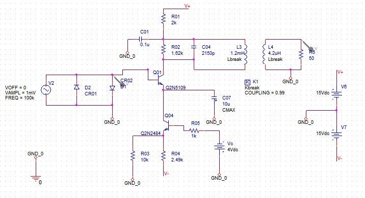

Hi all
I am trying to simulate input stage of a variable gain preamplifier for acoustic hydrophone operating in frequency range of 90KHz to 110KHz. It is transistor based preamplifier. The gain of preamplifier (Q01) is controlled through dc control voltage (Vc) connected with base of Q04 transistor through R05. I have attached the Orcad Capture Schematic snapshot.
The problem is that whatever dc control i set, output is still zero!
Any help in this regard is much appreciated.
Is ##V_C## connected backwards? Also, what is the purpose of ##R_{03}##? I'm not understanding that part of the bias circuit...
EDIT/ADD -- Where did you get this circuit from?
OK, I haven't really solved this circuit. It basically looks ok. But here are my impressions based on a bunch of quick calculations with big approximations and maybe errors:
1) The DC bias looks ok at about 4mA.
2) The first stage gain of R02⋅Ie/Vt is about 260. So 260mV into the tank output filter. I would expect something like 4 to 8V at the output.
3) The LC tank output filter looks OK at 100KHz and Q=2. The load isn't significant compared to R02 or Zc, but see the next comment. I'm assuming the transformer steps the voltage up, not down.
4) Is your transformer backwards? I'm not sure about the ORCAD notation, but if the magnetizing inductance is 1.2mH seen from the left side and 4.2uH from the right, that's a turns ratio of 17:1, right?
Have you verified the simulator measurements of internal stuff with "rule of thumb" analysis? You say the signal is zero. Where is it zero? Which voltages and/or currents?
Maybe @Baluncore can set us straight. He's good at this and usually works harder than us.
I think you have a modelling problem, not a circuit problem.
Simulation works in LTspice using 2x BC547.
Voltage gain is adjustable from 5 to 18, as Vc goes from -8.0 to -0.5 volt.
Transformer is matching Q1 collector load of 1k62 to 50R output.
Zratio = 1k62 / 50R = 32.4 down.

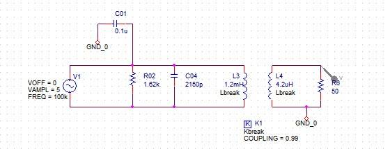

Thanks very much for help. I think you are right. I have problem in simulating the transformer in Orcad Capture as i am trying to simulate filter circuit connected with Q01 collector standalone and have following errors!
"ERROR -- Node N27120 is floating
ERROR -- Node N27066 is floating
ERROR -- Voltage source and/or inductor loop involving V_V1
You may break the loop by adding a series resistance"
Have you any experience with transfrmers simulations in Orcad Pspice?

Sorry, but no experience in the last 25 years with Orcad.
Spice simulators have a steep learning curve, which sometimes overhangs the climber.
I guess you have GND_0 floating because it is not grounded to ground node 0 of the simulation.
30 years ago I used PSpice a lot, LOL. Any knowledge there was lost long ago.
Like Baluncore, I'm an LTSpice convert. But really, I'm not a big fan of simulators for circuits that can be done by hand. Granted, you're stupid if you don't check with a simulator at some point. But they aren't great for design or understanding, you just get results.
Anyway, I think your next step is to either start deleting things, or build the circuit up bit by bit. Get rid of the transformer and see if that helps. The whole Q4 network can be replaced with a current source...
Also, recheck all of your trace junctions. I used to dislike ORCAD because traces don't (didn't) automatically connect. Maybe follow the old Mil-Spec rule that schematics should never have junctions where 4 (or more) traces connect. Then you only have crossings (not connected) and tees (connected). It makes it easy to check visually and (bonus! If you're a time traveler) is compatible with old crappy copiers and blueprint machines.

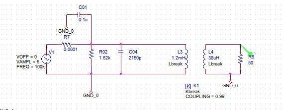

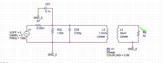

I am able to simulate by adding a small resistance in series with source V1 and grounding the source but still output is not correct i.e. 1mVpp across 50 ohm load whereas it should be around 800mVpp!
