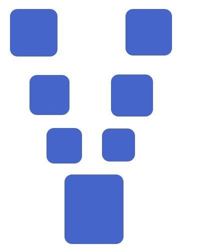

I basically need a function that will animate a chain necklace. Think of the necklace as having three square links on each side with a central medallion. I need this to swing like an actual necklace.
My biggest problem with this is the fact that I don't have a standard for gravity. Gravity has to be a function of x and y acceleration data received from an accelerometer.
I basically need it to swing using the two top links as anchors. I will also need it to be able to fall straight down if the object is held upside down.
I've been struggling with this for a while. Any help would be immensely appreciated.

I'm submitting a very simple diagram. The top 3 rows are "links" the single box on the bottom is the "medallion". I basically need this to swing as if it's being worn. so the top two "links" would be the anchors.
Now imagine the box is rotated on the x and y axis, kind of like if it laid down. I would need the pieces to swing accordingly in that direction, but still holding to the anchors.
I don't have the option of using a large simulator, as this is a very small project. It doesn't have to be perfect either. I just need some kind of formula to get these things to move correctly.
I'm including my attempt and calculating the x and y changes. The pieces are moved based on a fraction of this value, to slow the animation a little. This works to some extent. The pieces swing and fall in a swinging motion of sorts. I just can't get everything to anchor correctly, and the "medallion" floats to the left border of the screen and stays there.

Sorry, I can't completely follow your code. I'm not sure I know what all those variables represent. I think I can guess some of them, but others I'm kind of scratching my head on. I also don't think you should need to be taking the sign of anything as part of the code (this is really a vector operation). I can write you some quick and dirty code, but I'd really like to know exactly what you're working on and stuff if I'm going to contribute my leet skillz to the project. ;)
OK, so do you want these to be modeled as boxes anchored to each other at a pivot point? I mean, can the objects rotate like rigid bodies, or are you satisfied just modeling each of them as particles with no particular orientation? If that's not how they're connected, then how? Invisible strings modeled as ideal springs, maybe? Either that or rigid rods are about the simplest connectors I can think of.
Yeah, the code's kind of thrown together. Not really sure what I'm doing there. This is kind of a side project for me, so I haven't had a whole lot of time to work on it.
You can basically think of each link as having an invisible string connecting it to the next link. Like a necklace.
As far as how they move. Each box is an image. So I'm really just moving the image container. I would love for them to rotate like the would in real life.
Basically the idea here is for the box to wear the necklace. If the box rotates the necklace moves accordingly.
Sorry, I'm never very good at explaining myself. And quick and dirty code works for me. I have the app written for the most part, I'm just struggling with the physics.
Thanks

Objective C. Kind of different. If I can get the formula right, I should be able to translate it to Objective C without much problem.
OK, before I get too into this, it occurs to me that I should spell out for you what I'm going to do, in case you'd rather take a crack at it yourself.
I'm just going to use the naive and imperfect technique where you write all Newton's laws in differential form, and then do this little trick: if, for example, we know that:
v = dx/dt
then we can just take the initial value of x, assume some VERY small timestep dt, and rearrange that equation to get:
dx = dt * v
or to put it another way:
x_new = x_initial + dt * v.
So you just update all your quantities (position vectors using velocity vectors, velocity vectors using acceleration vectors, and acceleration vectors using forces calculated based on the tethers and the gravitation and stuff) at every timestep using all of Newton's laws of motion. In order for this corny technique to not suck too much, the timestep will have to be outrageously small. I don't know if it's going to work well enough for you, but with some friction in there to dampen things, I would bet it won't be too awful.
I don't know if that was clear, but that's what I'm a-gonna do.

Oh, cool, the catenary would work. You could even swing it like a pendulum. It wouldn't look perfect, I mean it wouldn't sort of bounce around the way a real necklace would. (At least, if there's a way to do that, I don't know about it.)
The catenary equation and other related stuff is http://en.wikipedia.org/wiki/Catenary" if you want to try it. The idea is that you would just make your squares fixed points along that curve, and just vary the curve so it has the right endpoints and hangs in the right direction. To make it swing back and forth, you just change the direction in which it's hanging, and slowly vary that direction in some sinusoidal way to make it look like it's swinging.
As I said before though, there isn't some formula that will just naturally model an object moving around in any random way. I mean, if you only want it to swing back and forth like a pendulum, that's one thing (that would be pretty much the catenary solution), but if you really want it to respond to an accelerometer as if you were shaking a box containing a necklace (which is what I thought you were saying), then you need a whole mess of code.
I'm not so worried about the box shaking. Although that would be cool to have that kind of response. I'm mostly worried about this acting like the box is "wearing" the necklace.
It sounds like the catenary is really what you want, then.
Unfortunately, I seem to suck at math, and cannot find the formula to get the x and y offsets of the catenary in order to fit two arbitrary points for a given a. I'm giving up for tonight.

If you had unlimited resources (i.e. time and processing power), then the thing to do would be to model your necklace as a bunch of squares constrained such the the distance between each one and its neighbor is a constant (that's the effect of the string). You then apply gravity and derive equations of motion. Those equations are almost guaranteed to be impossible to solve analytically, i.e. to produce a nice formula for the position of each square, but you could then apply a numerical integration algorithm (what you described earlier in a basic form) to solve the equations numerically.
This would work - in principle(!). Here are what I see as the main stumbling blocks:
1. The equations of motion are possibly not trivial to derive. If I were forced to do this, I would attempt to use something called Hamiltonian mechanics with Lagrange multipliers to provide the contraints of the strings. People smarter than I am might be able to do this in a reasonable amount of time - it would take me a certain amount of struggling. I would not, however, attempt to do this by simply applying Newton's Laws - this kind of problem is the reason Hamilton invented his formulation.
2. Numerically integrating the (probably) complicated equations of motion is probably going to be processor-intensive, and I have no idea if the processing a power available on current handheld devices is sufficient to do it in real time, i.e. to be able to display the results as you're moving the device.
I suspect you're going to have to make certain compromises in the name of practicality, but otherwise, this sounds like a nice idea.

This is what I'm doing now. One question: you have an X and Y acceleration of the box, I take it, but what about angular acceleration? Do we know that?

What I'm doing is much simpler. Like I said before, I'm just using a spring equation (that only kicks in after a certain distance).
Yes, I'm very well aware of the existence of proper algorithms to do this. I have no intention of doing that. Sorry, but that's just too much work. Like I said, I'm going to use Newton's laws because it's easy and might work passably well. There are only a few bodies in the problem. Like I also said, it will need a lot of damping, and may need some ad-hoc corrections because I'm not using a very good algorithm. If the phone doesn't have the necessary CPU to make it work decently, then I give up. If you can help solve the problem I mentioned with the catenary, that would be a great backup option. If you have any reasonable alternative suggestions, we're all listening.

Damn. This seemed so simple when I was outlining it in my head. The way I have it working now, I have the midpoint of each row of links acting as it's own pendulum. The links are a function of that midpoint position and an x offset.
That's almost working. I can't seem to get the links to gravitate back to the midpoint and I can't get the links on the right side to be constrained by the anchor on the left side, and vice versa. Also, like I said before, the medallion goes straight to the bottom left corner and stays there.
I feel like I'm so close, just can't quite get it.
