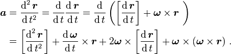

However, still remained one doubt, in this topic (http://en.wikipedia.org/wiki/Centrifugal_force_(fictitious)#Acceleration) there is the follow deduction:
Vector equations: a = d²r/dt² = d/dt (d r/dt) = d/dt ( [dr/dt] + ω × r ), then = [d²r/dt²] + (dω/dt) × r + 2ω × [dr/dt] + ω × (ω × r).
But I don't understood how
[tex]\frac{\mathrm{d} }{\mathrm{d} t}\left (\vec{\omega } \times \vec{r} \right )[/tex]
can be equal to
[tex]\frac{\mathrm{d} \vec{\omega }}{\mathrm{d} t}\times \vec{r}+2\vec{\omega }\times\left [ \frac{\mathrm{d} \vec{r}}{\mathrm{d} t} \right ]+ \vec{\omega } \times (\vec{\omega }\times \vec{r})[/tex]
How? Why?

\frac{\mathrm{d} }{\mathrm{d} t} \left( \left[ \frac{\mathrm{d} \vec{r}}{\mathrm{d} t} \right ] + \vec{\omega } \times \vec{r} \right)
= \left[ \frac{\mathrm{d} }{\mathrm{d} t} \left( \left[ \frac{\mathrm{d} \vec{r}}{\mathrm{d} t} \right ] + \vec{\omega } \times \vec{r} \right) \right] + \vec{\omega } \times \left( \left[ \frac{\mathrm{d} \vec{r}}{\mathrm{d} t} \right ] + \vec{\omega } \times \vec{r} \right)
= \left[ \frac{\mathrm{d} }{\mathrm{d} t} \left[ \frac{\mathrm{d} \vec{r}}{\mathrm{d} t} \right ] \right]
+ \left[ \frac{\mathrm{d} }{\mathrm{d} t} \left( \vec{\omega } \times \vec{r} \right) \right]
+ \vec{\omega } \times \left[ \frac{\mathrm{d} \vec{r}}{\mathrm{d} t} \right ]
+ \vec{\omega } \times \left( \vec{\omega } \times \vec{r} \right)
= \left[ \frac{\mathrm{d} ^2 \vec r }{\mathrm{d}^2 t} \right]
+ \left[ \frac{\mathrm{d} \vec \omega }{\mathrm{d} t} \right] \times \vec{r}
+ \vec \omega \times \left[ \frac{\mathrm{d} \vec r}{\mathrm{d} t}\right]
+ \frac{\mathrm{d} \vec \omega }{\mathrm{d} t} \times \vec{r}
+ 2 \vec \omega \times \left[ \frac{\mathrm{d} \vec r}{\mathrm{d} t}\right]

What? Why plus ω×([dr/dt] + ω×r)?
My equation results a different result:
[tex]\frac{\mathrm{d} }{\mathrm{d} t} \left( \left[ \frac{\mathrm{d} \vec{r}}{\mathrm{d} t} \right ] + \vec{\omega } \times \vec{r} \right) = \left[ \frac{\mathrm{d}^2 \vec{r}}{\mathrm{d} t^2} \right ] + \frac{\mathrm{d} }{\mathrm{d} t} \left(\vec{\omega } \times \vec{r} \right) = \left[ \frac{\mathrm{d}^2 \vec{r}}{\mathrm{d} t^2} \right ] + \frac{\mathrm{d} \vec{\omega}}{\mathrm{d} t} \times \vec{r}+\vec{\omega} \times \frac{\mathrm{d} \vec{r}}{\mathrm{d} t} = [\vec{a}] + \vec{\alpha }\times \vec{r}+\vec{\omega}\times\vec{v}[/tex]
Because for any vector ##\vec x##, $$ {\mathrm{d} \vec x \over \mathrm{d} t} = \left[ {\mathrm{d} \vec x \over \mathrm{d} t} \right] + \vec \omega \times \vec x , $$ where the square brackets denote differentiation in the co-rotating frame.
In this case we have $$ \vec x= \vec v = {\mathrm{d} \vec r \over \mathrm{d} t} = \left[ {\mathrm{d} \vec r \over \mathrm{d} t} \right] + \vec \omega \times \vec r , $$ so that formula is applied twice.
Now I understood! So, which is correct expression to d²r/dt² ? Is a + α×r + ω×v or a + α×r + 2ω×v + ω×(ω×r) ? My equation in post #4 is incorrect/incomplete?
The correct formula is given in #3. It is identical to the one in Wikipedia.

In actually, yes! Because the 2 derivations below seems be correct...

I know that your answer is correct, but I don't know why mine isn't. I followed the sum rule and the product rule correctly, not should have two different results for same equation.
In your derivation, you assumed that $$ \mathrm d \over \mathrm d t $$ and $$ \left[ \mathrm d \over \mathrm d t \right] $$ are the same thing. They are not, as shown in #5.
