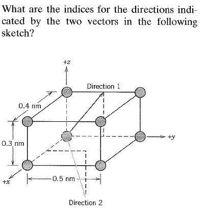

for direction 1 and 2, find the indexes x y z for both
n/a
direction 1 is 0,0.25,0.3 ?
direction 2 is 0,-0.3,0.25 ?
What is the definition of an index?
the direction [x,y,z]
Okay, I see the pic now. You are starting from the origin. Just calculate where the point is in the table.
I'm not quite really sure if I get this right since it is in 3D and is very confusing.
Now, I have Direction 1 [0, 0.25, 0.3]
Direction 2 [0.4, 0.25, -0.3]
Would you please verify if what I have looks good?
Thank you in advance
Yeah, now it looks good. If you need to justify the distances, ue pythagoras theorem.
Alright, thank you very much for your clarifications.
