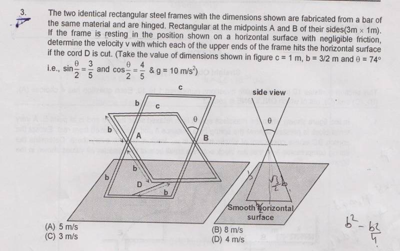

(see attachment, ignore those marks done with the pen)
I think this has to do with calculating torques and forces but I don't know about which point to calculate torque about. I know this is a very less attempt towards the problem but I can't really figure out the point about which to calculate torque about. :confused:

Can't you simply use conservation of energy?
Hi tiny-tim!
Initial energy=##2mgb\cos(\theta/2)## where m is the mass of one frame. (U=0 on the smooth horizontal surface)
Final energy=##mv_{cm}^2##
Equating them doesn't give the right answer. :confused:

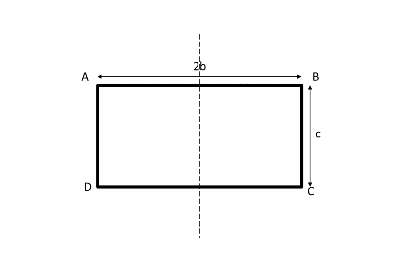

See attachment for the sketch.
The moment of inertia of AB and CD about the axis is ##4mb^2/12=mb^2/3##
The moment of inertia of BC and AD is ##mb^2##
Hence, the moment of inertia of one rectangular frame is ##13mb^2/12##. Is this correct?
Pranav-Arora said:
The moment of inertia of AB and CD about the axis is ##4mb^2/12=mb^2/12##
yes :smile:

Let ##ρ## be the line density.
Moment of inertia of AB and CD: ##(2b\rho )4b^2/12=2b^3\rho/3##
Moment of inertia of BC and AD: ##(c\rho )b^2##
Hence the moment of inertia of the rectangular frame is ##\displaystyle \frac{2b^3\rho}{3}+\frac{2b^3\rho}{3}+c\rho b^2+c\rho b^2=\frac{4b^3\rho}{3}+2c\rho b^2=\frac{2b^2\rho (2b+3c)}{3}##
where ##\rho=\frac{m}{2(2b+c)}## and m is the mass of one rectangular frame.

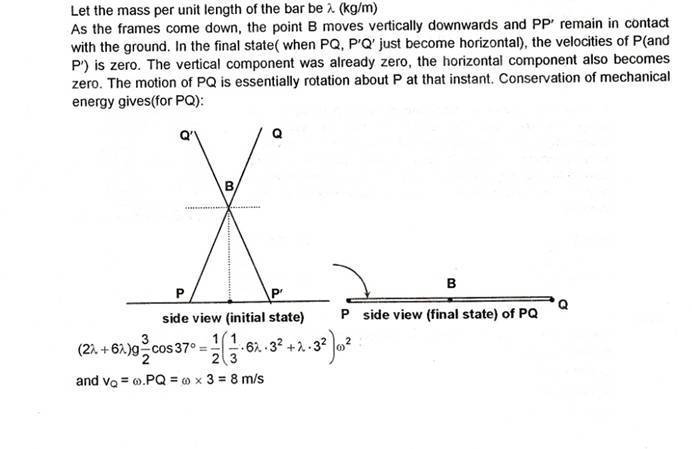

I have uploaded the solution presented in the solution booklet. I couldn't understand it so I had to post the question here. Can you please explain this? :)

btw, in case you're wondering …
the book takes moment of inertia etc about the endpoint, using the parallel axis theorem
we used the centre of mass
obviously, they came out the same!
you can always use the centre of mass (as we did),
but you can only use another point if it's the instantaneous centre of rotation (as the end is, but only at the instant the frame is flat)
