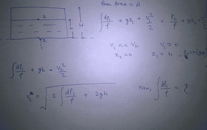

What I know: Below link is about Torricelli's law. Velocity of liquid coming out of bottom of the tank i.e comes after using Bernoulli's equation square root of (2*g*h*) where "h" is height of fluid in the container and "g" is acceleration due to gravity.
https://en.wikipedia.org/wiki/Torricelli's_law
Doubt: All the time problem was given with the case of open container. That means gauge pressure is zero on the top of the surface of liquid and at bottom of the tank. Now this is the case with tank is with lid closed. Now what I think; we cannot neglect the pressure term in the Bernoull's equation because it would be the function of the height of fluid being reduced. As tank is being emptied; the density of air above the liquid is reducing so the pressure.
Then another doubt comes what if there is increase in the rate of evaporation and maintaining the density of air above liquid surface.
Pls help me to find out the expression of outlet velocity; I know it would be decreasing with the passage of time.

ok let me correct myself;
Lets apply bernoulli's equation for the starting situation...> P1 (pressure at the top of liquid) P2 (=0 at pinhole) V1(=0 velocity of fluid on the top of liquid layer) V2(pinhole fluid velocity), h(elevation difference)
After applying bernoulli's what we get;
please see the attachment

But here P1 is the function of rho(density)

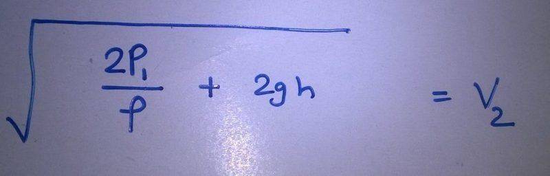

Where did P2 go?
jbriggs444 said:
Where did P2 go?
I am considering P1 as gauge pressure that's why P2 became zero
OK, so you have ##v_2 = \sqrt{2\frac{p_1}{\rho} + 2gh}##
We need to do some work on that equation. It has too many variables. We need to reduce it to one variable and a bunch of constants. If you look at post #2 I suggested using volume of fluid remaining in the tank as the single variable. Call that variable V.
##\rho## and ##g## are constants. Those are fine.
##p_1## can be expressed as a function of V, ambient absolute pressure, the initial height of fluid in the column and the total height of fluid in the column.
The current height of fluid in the column can be expressed as a function of V.
Start with those substitutions and we'll have most of the desired differential equation. Think about what you can do with ##v_2## to complete the job.
Why density is assumed to be constant? It is changing as we considered as isothermal expansion
Because we want a problem that is simple enough to solve. The variation of the density of an ideal liquid with respect to pressure is ideally zero anyway.

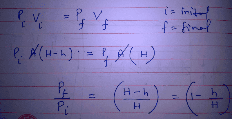

I see that you have done some work on the head pressure. However, your answer is not in the form I suggested. In the formulation we are after, h is a constant, not a variable. It is the initial height of the liquid. The variable we want to use is V, the volume of fluid remaining. The immediate goal is to express head pressure (##p_1##) as a function of V.
Once you have ##p_1## as a function of V, substitute that into the equation for ##v_2##. Be careful. You have shifted between gauge and absolute pressure without telling anyone. That's the second time you pulled that trick.
Edit: Please please, try to learn LaTeX. Hand drawn equations are no fun to read.
I misinterpreted the density as of air; I forgot it was of liquid. I admitted my mistake from shifting of gauge to absolute pressure. But I am not understanding how I could make p1 as a function of V. I am feeling helpless.
You know the starting volume of air in the headspace, yes?
You know the starting pressure of air in the headspace, yes?
You know the total volume of the tank, yes?
If you know the volume of liquid remaining, then know the current volume of the headspace.
You have been given the assumption of isothermal expansion.
What is the pressure in the headspace?

Starting volume of air in the headspace=A(H-h)
Starting pressure of air in the headspace=P(atm)
Volume of the tank=AH
Volume of liquid remaining=Ah-Ax; where x is depth of fluid remaining.
Current volume of headspace=A(H-h)+Ax
Current pressure=P2
(P2)*(AH-Ah+Ax)=P(atm)*A(H-h); isothermal expansion.
here P2 is dependent on the variable "x"; all other are constants.
So by "depth" of fluid, you mean the amount by which its current surface height is below its starting surface height? That's fine. We can do our differential equation in terms of x rather than in terms of V.
Let's write that last equation neatly in LaTeX and put ##P_2## along on the left hand side. Dividing by ##AH-Ah+Ax## we get
##P_2=\frac{AP_{atm}(H-h)}{A(H-h+x)}##
## = P_{atm} \frac{H-h}{H-h+x}##

Now, can you put this together and write the current flow velocity in terms of x using TeX? If you look at post #9, you'll find a good start.

Leave the equations for the time being; let me rewind the all concepts used here.
Bernoulli's applied but making pressure term as variable. Gage pressure used first; so after finding pressure variation; P(atm) must be subtracted from the absolute pressure term.
Isothermal expansion; pressure of headspace became the function of the depth of fluid.
Anything else.
Anything else.
You also have to account for the pressure from gravity based on the current liquid depth, of course.
