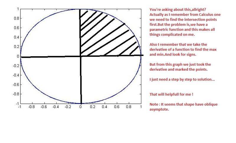

Ok.You're right,I have to understand the general mode.But I can't find any documentation how to do all these on any trigonometric function.All of them are polynoms.

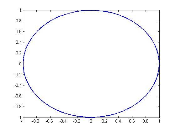

Is it the graph of function?
Yes. You can see this very easily by eliminating the parameter and getting x2+y2=1.
