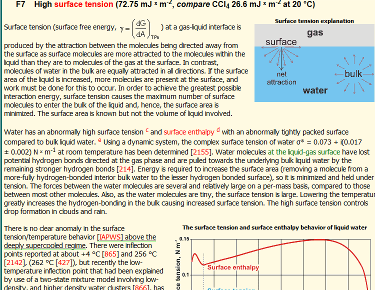

why isn't Surface tension reliant on the composion of the atm?
For an instance; If you place a glass of water in a room with regular atmosphere or you place it in a room filled with other gasses. The coefficient of surface tension of the fluid will change? Maybe?

This is not my area, but from a quick Google search, it looks like the main affect would be due to the pressure of the gas at the gas-liquid interface, not so much the composition of the gas. This looks like a good article:
http://www1.lsbu.ac.uk/water/physical_anomalies.html#ST

The atmosphere can have an impact on the surface tension of the fluid because (for your proposed example, assuming equilibrium) the fluids are effectively different. The gas will dissolve into the water - that changes the fluid. Depending on the gas(es) you select for your 'alternative atmosphere', that change may be readily measurable.
