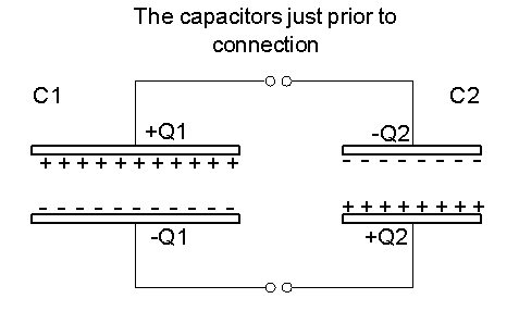

A 3.0 µF capacitor charged to 40 V and a 5.0 µF capacitor charged to 18 V are connected to each other, with the positive plate of each connected to the negative plate of the other.
b. Find the potential difference across the capacitors.
Do you just add up the potentail differences? 18 + 40 = 58V?

Nope. There will be charge movement (and cancellation) that happens when the capacitors are connected. Sketch a diagram showing the plates with their charges before connection, then work out what charges will move where when they are connected.
Sum up the charges?
3.0 µF * 40V = 1.2 *10^-4C
5.0 µF * 18V = 9 * 10^-5 C

Sum the charges taking into account their polarities on the capacitors. Did you draw the sketch that I suggested?

Can you draw one charged parallel plate capacitor?
[PLAIN]http://img641.imageshack.us/img641/2150/unledgkx.jpg
Do the charges really sit off to the side of the plates?
No the plus and minus just indicate which plate is positive and negative.
Okay. So you've calculated the individual charges that exist on each capacitor. Draw two capacitors side by side (unconnected as yet) and label each plate with the charge that exists on it.
When the capacitor plates are connected as specified, what will happen to the charges?
Do they merge together to become one big charge? If so why is it leaking?

Charges combine -- They add or cancel depending upon their signs. You do remember that a + unit charge will cancel with a - unit charge, right?

While it is okay to show the polarity of the voltage across the capacitor as you have here, with a + and - it may lead to confusion. When you know the voltage difference, as we initially do here, it may be better to label one plate as +40v and the other as 0v.
Otherwise, I think you may be tempted to then proceed to wrongly label one plate as +40v and the other as -40v, and that would be wrong because it would describe a potential difference between the plates of 80 volts, not 40v.
A capacitor is only concerned with potential difference across its plates. That's all it sees, that's all it feels, that's all it knows. And that potential difference is wholly due to the charges on the plates. Q=C.V
Don't worry about doing any calculations until you have drawn and clearly labelled a couple of diagrams to show you understand the situation before and after. If you can't get the diagrams right, then you are wasting your time doing any calculations.
When the two capacitors are connected together, there will be a momentary spark. This indicates a brief flow of current through the connecting wires, and current denotes the movement of electrons through those wires.
OKay so once the capacitors are hooked up the charges combine to become one current in one branch
so Q = 2.1 * 10^-4 C

Can you draw a picture of that? How did you calculate Q?
Any current that flows will be very brief as the charges sort out their new distribution. Note that in the end both capacitors will still have a charge, it just won't be the same charge that they started out with.
[PLAIN]http://img37.imageshack.us/img37/2847/unledzz.jpg
I just added the charges from each plate. Should i divide it by 2 to average it out then?
Both terminals of each capacitor will be connected -- the capacitors end up in parallel (See attached figure). Which charges have access to each other via conduction paths once the connections are made? What will be the result?

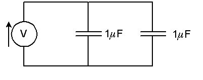

Why is it connected in parallel and not series?

With only two components, connected as shown, you could consider them connected both in series and in parallel if you wish. The net capacitance of the pair will be calculated using the parallel connection formula because the plates are in fact connected that way.

Looks aren't everything :smile: Drawing orientation on the page is irrelevant; Wires do nothing except provide connections, and their length, orientation, or twisty-turneyness make no difference -- everything connected by a single wire path in a circuit diagram is the same node of the circuit; Only the actual connections made are important.
Check how the component terminals in your circuit are connected. If both components' terminals are connected to the same nodes (so that they have shared potentials at both terminals), then the components are in parallel.
If the current through one is always equal to the current through the other, then they are in series. :)

So... these two capacitors must be in series then? :smile:
No. Because if I trace the electron flow through one capacitor, it does not pass through the other. So the branches are not carrying the same current, so they cannot be in series.

But that wasn't your claim. You said: "If the current through one is always equal to the current through the other, then they are in series." Clearly, both of these capacitors will always carry equal currents. :devil:
wait why is there a power supply now...?

Returning to the OP's problem (flyingpig), he will find it convenient to use the "leads connected to the same pair of nodes" definition for parallel connections, and proceed along those lines. The capacitors, taken to be in parallel, will allow him to calculate the charge remaining on the pair, the net capacitance, and thus the potential difference.
Sorry, flyingpig, this is just part of a tangential discussion that sprang up regarding how best to define "series" and "parallel" connections for components.
As I stated previously, the two capacitors in this situation are the only components in the circuit, and the argument can be made that they are connected BOTH in parallel AND in series. Analysis can proceed using either assumption. Your choice.
