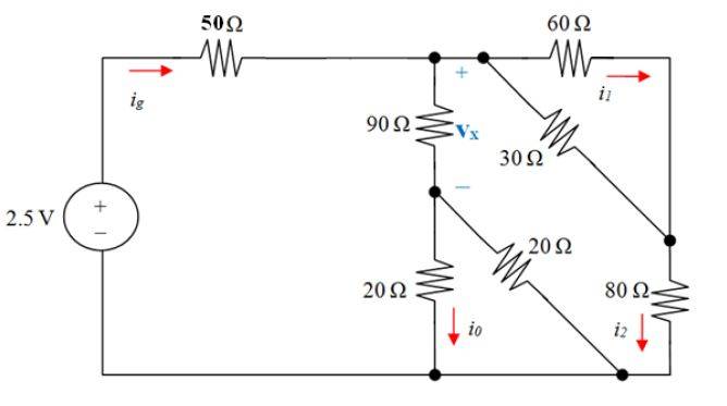

sevag00
80
Calculate ig, i0, i1, i2, Vx using current and voltage divider.
http://s13.postimg.org/77gjkkmgn/001.jpg
You were doing fine until you got to the calculation of Vx. There's no way a potential drop in the the circuit can be larger than the supply voltage...
Yes you're right. I didn't pay attention to that.
V should be 1.25V(voltage divider on both 100 ohm resistors) and Vx = 1.125V (voltage divider between the 90 and 20//20 ohm resistors)
Muuuch better :smile:
You could also have just multiplied your i3 by 90Ω.
Yay!
