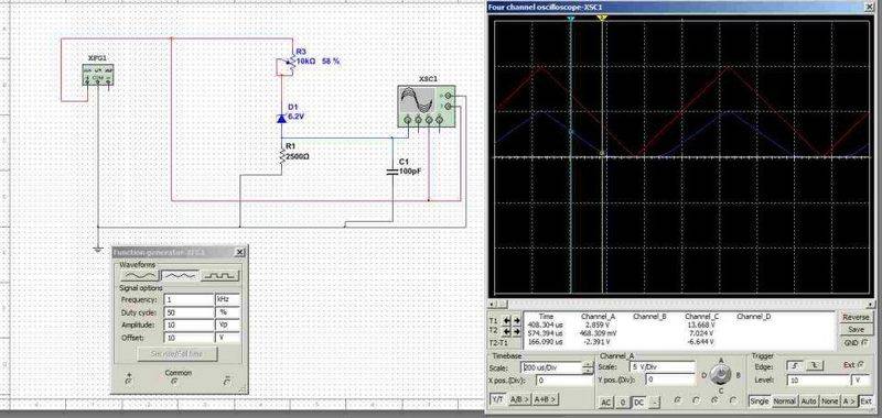

I'm working on an Arduino project to read automotive battery voltage,.. I could use a simple resistor divider circuit, but I'd lose a lot of resolution (you aren't going to see <8V very often)..
Could anyone take a look at this and tell me if it's a reasonable method?..
Channel A (Blue) is 5V/div
Channel C (Red) is 10V/div
Frequency is 1khz, which is plenty fast enough for what I need
It seems to have good linearity from 10-20V, I will use a multiturn trimpot for R3, 1/4W metal film resistor for R1
It should give me a resolution of about .015V in the working range, I'm fine with that.
Is there anything I'm missing that could come back and bite me in the arse?

I don't think a zener diode is precise enough to do what you want. Temperature changes will bite you in the butt. You could use a precision reference or a plain old voltage regulator and feed an op amp with both the reference and the divided down sample voltage for a differential amplifier. Set the gain of the amp so you get the range you want. I suppose the alternative would be to use the zener but run it pretty hot to minimize external temperature effects. You will obviously not be using resistor values that you have chosen and will be wasting some power. There are some precision references that are used in circuit similar to a zener diode. That could also work depending on whether or not they are available at the offset you need. If you want a true offset you cannot have the pot where you have it placed when using a zener type device. It will not only have offset but will form a divider. When you dial the pot to correct for the offset you have also changed the ratio of the voltage divider.

Thank you, exactly the kind of bite-my-arse things I wanted to know about...
In this instance I can afford to put some power through it, I changed R1 to 57Ω and trimpot to 100Ω fixed resistor.. This yields about the same curve, but increases the current through D1 to about 200mw average and 50mA
I'm really limited for space for breadboarding this together, which is part of the reason I am trying to keep component count down.
How drastic would the temperature change this? It's primarily for display purposes, though in the distant future it could be for charge control as well, Is the penalty of decreased resolution (20V/1024 = 19mv) from a plain resistor divider going to pay off in thermal stability? It's kinda looking like it to me (and the bonus of even simpler)
I tried referencing the lower leg of R3 to ground instead of the wiper, but what I found was it really affected the linearity in the lower range

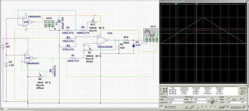

Here, Is this more like what you had in mind @Averagesupernova ?
The 2.5V supply would actually be an LT1004-2.5V bandgap reference diode which I just happen to have, though I don't have a model for it http://cds.linear.com/docs/en/datasheet/1004fb.pdf
The op amp I would use is a very linear OP77FP, 140dB gain, 130db CMRR/PSRR (I happen to have some)
That looks about right. Set R5 so that the middle of the range you want to measure will put 2.5 volts on the non inverting input. Set R1 to put the range you want to measure within the useable range of the op amps output. Once you have everything dialed in, get rid of the pots and use fixed resistors. Use precision if you think you need them.

I've been poring over that Bournes pot tutorial posted earlier.. I'm at a bit of a loss at how to avoid connecting the wiper directly to the op-amp when you need a voltage divider... I've gone through my circuit and added another op-amp, and a few other things..
U1A controls the response slope alone, not perfect, but it's fed by a 6.8V limited supply, which clips the output around 5.3V, giving the microcontroller a fighting chance if someone messes up while adjusting. (like that would ever happen)
U2A controls the offset voltage alone, the 1.2V reference is a battery in this case, in reality it'll be the 1.2V LT1004 or similar reference
I'll be able to tweak the trimpot values a little with external resistors

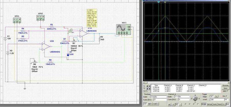

It looks like you've fixed the trimpot issue. :smile:
I'd be inclined to do this simply with a 5.1V Zener diode (hint-hint) as the reference, and a voltage divider with 1% resistors for the other side of the differential subtraction opamp stage. Sorry if I missed it in your posts -- what is your desired accuracy? And can you just calibrate it a bit in your uC code?
Yes, the code would certainly have to re-map the values, which is trivially difficult.
Here's what I consider "as good as it needs to be" for my purposes... 7-17V full scale with decent linearity, full clipping at 5.1V.. I changed the final op-amp to a higher quality one and it really helped the linearity.
I might just be getting the hang of this!

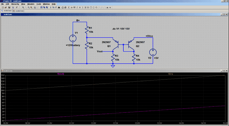

Here is a simple circuit that uses Vcc = +5V, along with 4 identical resistors and two identical PNPs to subtract 10 volts from the battery voltage. It produces a 0 to 5 volt Vout.
Interesting... so V1 is your variable source voltage, V2 is fixed 5V?
I'll have to draw that up and play with it a little :)
Yes. V1 is swept from 10V to 15V.
The Q2 emitter is held at Vcc = 5 volts.
Q2 is connected as a super-diode that will have a very similar Vbe to Q1.
The Q1 emitter is therefore also held close to +5V.
R1 sources a current = ( Vbatt – 5V ) / 10k
R2 sinks a current +5V / 10k
The difference current flows through R3.
Vout = 10k * ( ( ( Vbatt – 5V ) / 10k) – ( +5V / 10k ) )
Vout = Vbatt – 5V – 5V

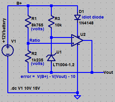

Here is a similar circuit that uses an op-amp to eliminate the temperature variation between transistors.
And another that uses a 1.235V reference to subtract 10 volts from B+. Use a "rail to rail" op-amp to get close to ground.
