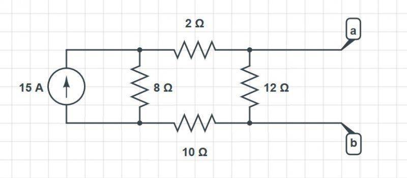

Task: Find the voltage across the terminals a and b in the circuit (Done).
My question: Why does the solution work?
Current division
ix = Isource * Gbranch/Gequivalent
The voltage across (or is it between ?) the terminals is the same (why ?) as the voltage drop at the branch with the 2, 12 and 10 Ohm resistors, which is 45 Volts. This was found by first finding the current flowing through the branch with the current division principle, i = 3.75 A.
As I stated above, why is the voltage across the terminals the same as the voltage drop at the branch with the 2, 12 and 10 Ohm resisotrs?
The circuit is attached below.

Hi Gecata, Welcome to Physics Forums.
Yes, voltage (or potential difference) is measured between two points or across a component. Current goes though a wire or component.
Perhaps there's a terminology issue, but I 'm not entirely clear on your problem. Can you show your work?
Actually I see the answer to my question now (not really a question apparently).
The terminals A and B are open, and I needed to determine the resistance between them, in order to model a Thevenin and Norton equivalent circuits.
The confusing momenta was not really paying attention to terminals A and B being open.
I saw my mistake after reading your answer, so in a way you answered my question. Thank you.
It's not just because a and b are open circuit...
Points a and b are connected to the 12 ohm resistor by ideal wire so the voltage Vab will always be the same as the voltage across the 12 ohm resistor... EVEN if points a and b were connected together with a wire, another resistor or something more complicated like a battery. For example if you connected a and b to a 10V battery the voltage drop across the 12 Ohm resistor would be 10V.
Yes, I understand that. My confusion was caused by something else entirely, namely not enough experience with circuits. Thanks again for the explanation.
