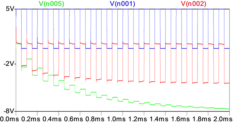

Sorry, several incorrect statements:
  1. It is a negative voltage doubler.
  2. The statements regarding the capacitors are correct.
This is a simulation of the circuit. The blue trace is the output of the pulse generator. The red trace is the voltage across D1. The green trace is the voltage at the output (junction D4/C4).
It is certainly more than a doubler. The actual measured output may not be quadruple of the peak voltage but in any textbook I have seen this would be more than just a doubler.
Oops - we are talking about two different things here. I am used to thinking about generating a voltage from a pulse train - and then the circuit doubles the pulse amplitude. But if you are talking about a sine wave AC input, the circuit quadruples the sine wave amplitude (the sine wave amplitude is half the peak-to-peak voltage).

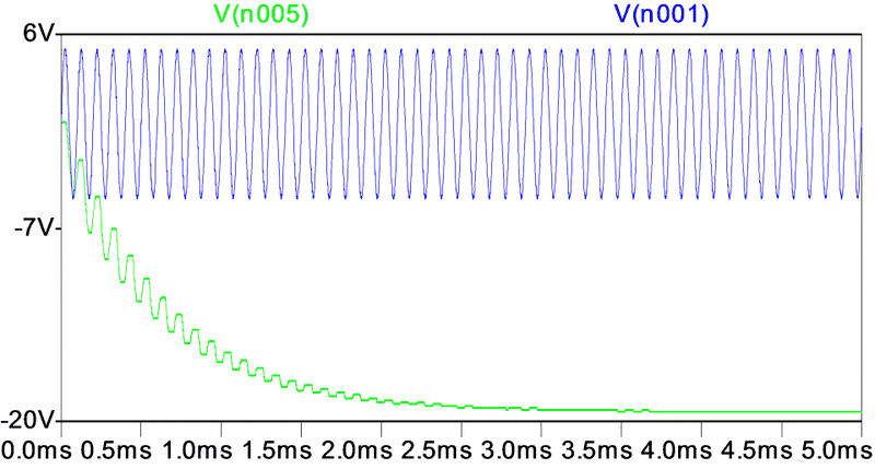

Here is a simulation with a 5V amplitude sine wave at the input. The output is then 4 times the amplitude (and 2 times the p-p voltage).
There really is no difference. It's just how the input is spec'd. An AC voltage that is typically driving a voltage multiplier in a power supply is always spec'd as RMS. The attachment in post #7 is no different. Typically we don't spec 0 to 5 volt 50% duty cycle waveform as 2.5 volt RMS but it still multiplies it in the same manner.
Thanks a lot , this images really helped me to understand it ... I'm grateful for that my professor :smile:
