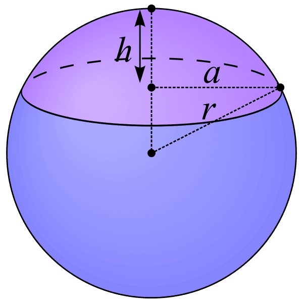

Let a sphere of radius r be cut by a plane, thereby forming a segment of height h. Show that the volume of this segment is (∏h2(3r-h))/3

The surface of the sphere is defined by the equation:
x^2 + y^2 + z^2 = R^2
A plane parallel to the x-y axis which intersects the z axis at the point (0,0,h) will create an intersection with the spherical surface which is circular in shape. The radius of this circle will be sqrt(R^2 - h^2).

First decide how you are going to carve the segment into elements.
I would choose a washer structure: for a given z, R-h < z < R, there is a disc at distance z from the centre of the sphere, thickness dz. What is its area?
Or with the shell approach you could carve it into concentric cylinders (of varying lengths) centred on the z axis. In this case, a given cylinder has radius r = sqrt(x^2+y^2) and thickness dr. You need to figure out the range for z in terms of r.

If you centre the sphere at the origin then z ranges from r-h to r.

The attached picture shows the spherical cap:

thanks a lot for the picture, i'll try to understand this again.
edit: I'm still thinking it goes from (r-h), the lower bound, to r at the north pole of the sphere. But "r" starts outside of the region! :(

That's what SteamKing's picture shows. Measuring z up from the centre of the sphere, z runs from r-h (the lower end of the arrow labelled h) to r (the top end of that arrow).
I don't know what you mean. r is the radius of the sphere. Where does it 'start'? Do you mean the origin?
yeah, it lies outside of that purple region. It seems just as useful to have 2r-h for that distance. I'm just measuring back to the start of the purple area anyways.
