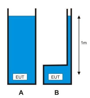

For an IP67 rating (http://en.wikipedia.org/wiki/IP_Code), an electrical enclosure must be submerged to 1m for 30 minutes with no water ingress.
A basic test setup is shown in Fig A with the EUT ( Equipment Under Test) placed at the bottom of a tank.
Two side-by-side diagrams labelled A and B of a box-shaped equipment under test (EUT) at the bottom of water-filled containers; A is a straight tank, B has a thin tall pipe rising from the chamber, with a 1m depth arrow on the right.
An alternative test setup was proposed to me, as shown in Fig B.
This setup has a thin pipe into a closed chamber, with the same overall depth of water.
I want to say that the pressure on the EUT is the same with the two setups, but my intuition says otherwise.
So, does Fig B result in the same water pressure on the EUT as Fig A? Why?
  • Two side-by-side diagrams of water tanks, labelled A and B, each with an EUT box at the bottom; tank B has a narrow tube rising from a wide base, with a 1m depth arrow beside it.
