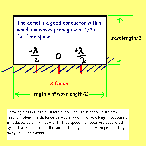

For clarity, again there are no individually-driven dipoles in a planar aerial.
Please refer to the diagram

I now see the diagram and would agree that (allowing for the Earth, implied) underneath) the arrangement will launch a wave, radiating outwards with a Horizontal Radiation pattern that is not easily to determine (could have maxs and mins in all sorts of places) and a VRP which will have a minimum vertically.
To determine the pattern accurately, you would need to know the currents, phases (and directions, I suspect) all over the plane. Not a trivial exercise.
In many ways, splitting the array up into insulated vertical strips makes the calculations much easier - but you need a lot of feeds for that.

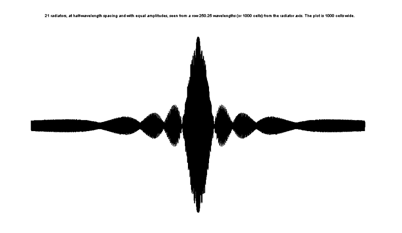

I'd like to try about 21 notional dipoles.

Well, the simulations are ridiculous. Nothing could be that good, et cetera.
