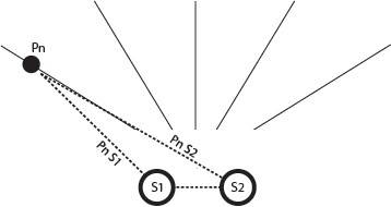

* note that this is a diagram I've made... I can't get the image out of the book for you at this moment but it's basically like this with wave interference lines... The dotted lines are obviously my nodal lines and I drew the triangle over it.
Do they just want me to measure this with a protractor and ruler?
For the wave I measured crest to crest...
With S1 being the left source at the bottom, is this what I'm supposed to measure?

I believe you mean the variables Pn, S1 and S2.
I believe these are points to make lines. Pn is the black dot on the nodal line.
S1 and S2 are the sources of the interference.

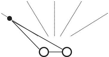

Here is a labeled diagram with what I think I'm supposed to measure...
I measured this with a ruler.
(Crest to Crest) λ = 8mm
S1S2 = 23mm
PnS1 = 46mm
PnS2 = 63mm

|P1S1 – P1S2 | = (n - ½) λ
|46mm - 63mm | = (n - ½) 8mm
17mm = 8mm ∙ n – 4mm
21mm = 8mm ∙ n
n = 21mm/8mm
I don't think mine is right because 12/8 is a fraction and not an integer.

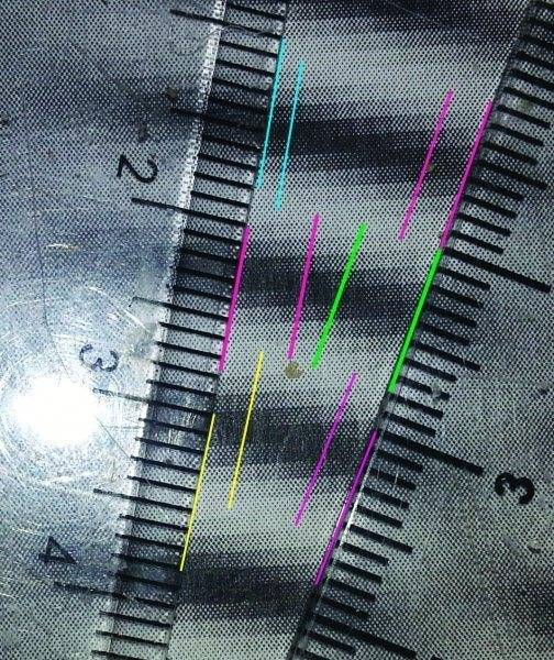

How did you measure wave length. Did you just measure just one single wave? Measure the length for several waves - let's say 8 consecutive - then divide to get a more accurate value.

I did a eight measurements and came to 0.795 average for λ

If the sources are out of phase (180°) then the center line is a node rather than an anti-node. It does occur where there is zero path difference from the two sources. I would use an index of zero there.
Point P is also on a nodal line. It's the second one over from the center line, so, I would give it an index of 2 .

If you're averaging eight separate measurements, each of a single wave's length, then I would consider that to be of questionable accuracy.
My suggestion is to start at some crest and measure the whole span to maybe the 8th or 9th crest. Then divide by the number of waves that represents. Do that along a few different anti-nodal lines & average.
It's pretty inconsistent to say the least... Here I averaged 8.06mm but it's only estimation by eye out of 6 tries...
