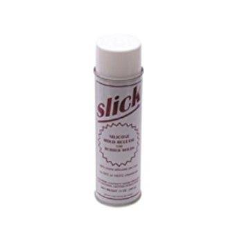

There are different kinds of Mold Release Agents that last fairly long and is really slippery. e.g. https://www.amazon.com/Eurotool-Mold-Release-Spray-CAS-128-00/dp/B0058ED9OC

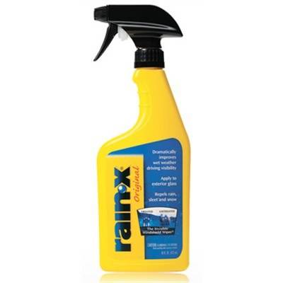

I've even used Rain-X as a mold release when making carbon composite components.
