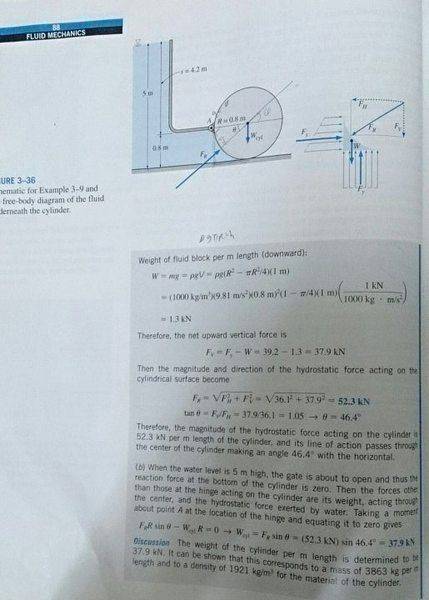

What is the formula for the weight of a fluid block?
The formula for the weight of a fluid block is derived from the area of a square minus the area of a quarter circle, represented as ρg[(R^2) - π(R^2)]. The "1m" refers to the weight calculation being for a 1-meter length of the shaded area in the diagram. The discussion raises a question about whether the formula should instead be expressed as ρg(π)(R^2)h. The confusion stems from the interpretation of the areas involved in the calculation. Understanding the geometric shapes is crucial for correctly applying the weight formula.

why the formula of weight of fluid block is given by the formula of ρg[ (R^2) - pi(R^2) ] 1?
what does the 1m mean here ?
shouldn't it = ρg (pi) (R^2) h ?

It's a square minus a quarter circle. ##W## is the weight of 1 m length (i.e. into the paper) of the area shaded grey in the right picture in Fig 3-36.
