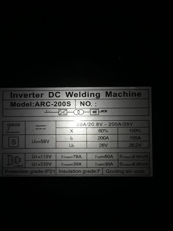

How is it possible for a welding machine to end up creating more power than what it started with if that is physically impossible? For ex; 200 amp @ 28vdc welding machine. starts out with main voltage being 120v @ 20amps = 2400 watts then converts it to 200 amps at 28vdc which = 5,600 watts of power.
It doesn't

200 A is the highest output current setting. Doesn't mean it occurs at 28 VDC

Please provide a link to the datasheet and user manual for this welder, or attach a picture of the nameplate. Something like this:
zoki85 said:
It doesn't
That's odd because the back of my welding machine says it does.

I believe there is a number that implies a 60% duty cycle (this must be PWM DC somehow?) So 3,360W out ? (did it in my head...always risky). Whew. Both the integrity of the welding folks and physics is preserved!

28V is the open circuit voltage. 200A is the maximum (near short circuit) current. Once the arc is struck, the voltage drops.
To put it another way, 200A and 28V don’t occur together, so you can’t just multiply them.
The single phase, 50 Hz input sinewave will be rectified to high voltage DC in a capacitor.
The input is rated in kVA not kW because the rectifier input is not resistive.
220 V * 39 A = 8.580 kVA.
220 V * 30 A = 6.600 kW effective.
The continuous DC output is 155 A * 26.2 V = 4.061 kW.
The 60% duty output is 200 A * 28 V = 5.600 kW.
The output power is less than the input, so conservation of energy is OK. No problem.

Where do you see 20A? Isn't that the input parameters at the bottom of the nameplate photo? 78A at 110V?

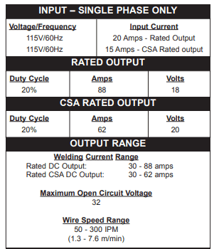

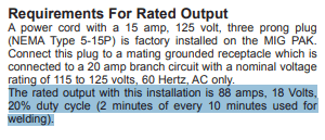

I think OP might have bad/misleading labels on the machine. My welder for reference (only a small 90A mig by comparison):
Rated amps*rated volts 88A*18V = 1600W, it pulls 20A from 115V = 2300W, unfortunately no free energy here.
Note that the duty cycle in welder terms is a thermal limit. Due to the size of the transformer this has fairly slow time constant, and it usually is telling you how much you can weld in 10min:

Wow. Forgive me, but your welder must be very irritating to use. Most give the duty at full output, and also the output at 60% duty, which I assume is considered reasonably usable. In a typical project, the time taken between welds to set up, clamp, mark etc means a 60% DC won’t cramp your style.
Given that a 20% DC means 12s on, 48s off, over the whole project it would take the machine a full minute to do each 2” or so of weld bead.
When buying a welder, the advice is to get one that has at least 60% DC at the output you will tend to use, rather than to look at the maximum output. The quality can be estimated by how the DC falls off as output rises.
