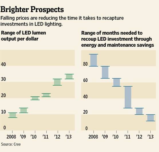

I was curious about the limits of what might be done to the electrical load in the Florida example by reducing, say, lighting load by replacing existing lighting with LEDs. FL's total electric consumption rate is ~28GW per EIA. For the US at large, about 13% of the load is lighting. In FL electric use is above average due to air conditioning load, so I guess lighting is only 10% of FL electric consumption, or 2.8GW. LED lighting is roughly 10X more efficient than incandescent and 2X more efficient than florescent. Thus the FL load would fall as much as 2.5GW (all existing incand.) to 0.28GW and as little as 1.4GW (all existing florescent) to 1.4GW if every light was replaced with an LED. LED lighting costs about $3/W (and falling), so worst case the material cost is $4.2B. That's still considerably more expensive than a new 2GW gas plant, but considerably less than the cost of the proposed Levy county nuclear plant.
I am sure you are aware that LED and flourescent lighting have already achieved some market penetration, so your numbers probably overstate the savings. I acknowledge that there are efficiency gains to be had and there is discussion in the EIS for Levy county of that potential (see discussion of no construction alternative). But even if your numbers are correct, you have only covered the generation of the nuclear plants for load growth(see certification of need for Levy county), but haven't covered the replacement power of the shutdown of the older coal plants to achieve Florida and EPA emission goals.
Finally, even with efficiency savings, and the (supposedly) cheap alternative of natural gas, there will still be the issue of CO2 emmissions and Florida goals to consider. Again, this is still under research, if you have any details about that, please post.
This seems to be a valuable discussion. So please hang in there. This is all good information, even if we don't agree.
