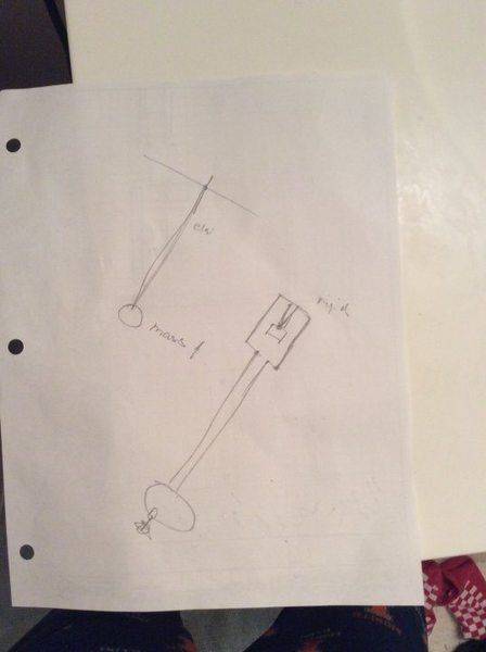

Is it possible to have a pendulum that has a single pivot point. So instead of the pivot be a rod, it would be something like a needle on a metal piece that turns. Check below for a sketch.
Looks like a metronome.

Right now I am leaning towards a pendulum, but what can I do to make it very consistent? I considered an escapement wheel so that a) it makes counting by seconds easier and b) it will give the pendulum a little push. However, the precision that takes is too much. Unless someone can find an escapement that is easier to make than a deadbeat escapement.
